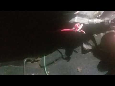

The idle throttle idea I got from Carl Zin and it is a worm gear aluminum window crank that I took the arm off and used a red 18 gauge stranded wire that pulls on the accelerator linkage.
Here is a short video of it working
