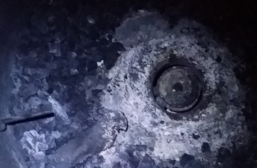

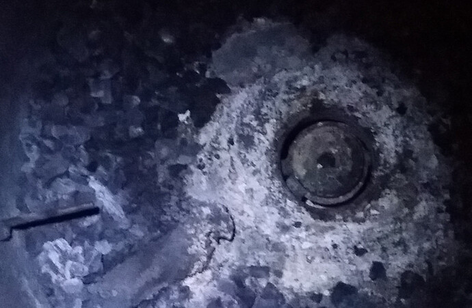

Seeing we are expected to do a little show and tell at Argos about charcoal powered vehicles, I thought I should empty the charcoal; out and take a look at the nozzle area from the top in order to know a little more about workings of my machine. . So I did that and here is what I found today. After sucking the last bit of charcoal with my shop vac I found the nozzle to be in excellent shape. It appears that the charcoal descends to the center of the nozzle area and then oxidizes and reduces in an outward loop because that is where the ash and clinkers are found in a ring around the nozzle area while the area above the nozzle center vacuumed out clean. The end of my lighting tube terminated about 3 inches from the edge of the nozzle but the end still melted off with the intense heat of the reaction. The thermocouple just above the lighting tube never showed temps over 1500 F
Thatās incredible Don , sounds like you may have a winner there for longevity on the nozzle front well done .
Good luck to all at Argos meeting this weekend hope its a great one
Good for you Don. I still donāt understand that nozzle and was hoping to get to talk to you in Argos. Does that nozzle spin or do you turn it or does it just occellate and keep the oxides off the nozzle. Next a new lighting port. You will get it Iām sure. Have fun in Argos. TomC
Tom, there is a handle on the side of the ammo box that I can wiggle to let ashes fall. I found out I cannot turn it too much cause it will bind with pieces of charcoal. Air rushes up around the narrow space between the center part and the wall of the nozzle to cool it and provide velocity which keeps the hot zone above a little way.
