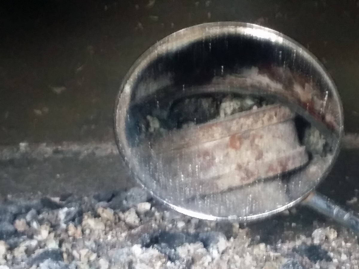

I took a look at the nozzle yesterday after about 4 hours run time and although that is way too short of a time to judge long term reliability it does say something when I see no signs of oxidation or wear.
