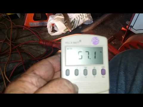

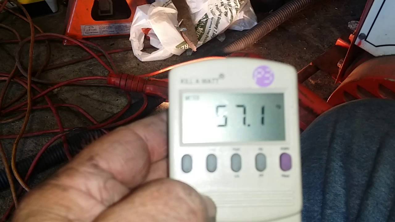

I had a little time this afternoon to play with my generator powered by Tracker charcoal wood gas. I was concerned at first that the nozzle would be to big to run a small engine but after today it looks like there is a lot of forgiveness with this nozzle size because it ran for over half an hour with no signs of cooling the reaction. I will have to make some adjustments to the engine to get the hz rate at 60 hz from the present 56 - 57. Maybe opening the breaker arm gap and closing the spark plug gap and tweaking the governor will do the trick. It ran a 100 watt light bulb and my 2 hp air compressor just fine. I have to get a better muffler on it because I canāt hear myself think when it is running. Stay tuned.

Don, I read yesterday that you had trouble running a small engine using your Tracker gasifier. My immediate respose was āThere should be no problem.ā but decided not to reply at that time. Iām glad to see you tried it again and got it working. To my thinking it is easier to under size a charcoal nozzle than over size one.
BTW, at Argos I used the Ford Ranger gasifier to run a small 2000watt generator. There was no problem keeping it running once the entire system of gasifier, cooler, filter and hoses were filled with good quality chargas, Keep up the good work. You are helping to lure more and more over to the ādark sideā
Gary in PA
Yeah Gary, I was too much in a hurry Saturday because I had that car show on my mind. I did again that thing that I am pretty good at. A S S U M E . I assumed that the choke lever would be parallel with the carburetor in the off position but in reality this one is perpendicular with it, so I was playing around with it half way and back and forth trying to get it up to speed until it quit. I also did not add any water drip either time. Next time I will play with that, among other things.
