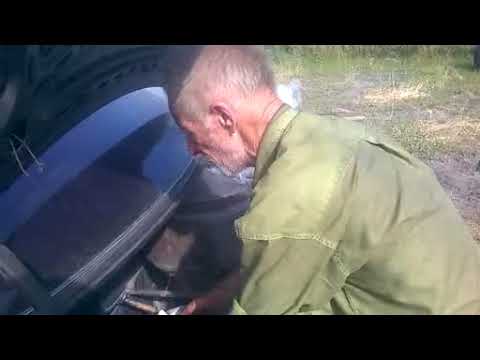

This why it is very important to make sure the breeze is blowing in the right direction when you load your hopper. Yikes that car is really smoked up inside. He needs a stronger sucking fan that’s for sure.
Any rats in the car will come out waving a white flag
Ooooh l know that too well… its why you will have a hard time preswadeing me in to making a wood powered sedan again haha

Good Morning Kevin,
The primary mistake I think they are discussing is that this man failed to air/gastight put in a fire proof metal wall separator between the back seat and the trunk /boot area.
And with his system he should even run with the trunk lid removed.
And just as obvious he is top-up refilling at the wrong time with too much raw hot smoking out fuel remaining.
Run the raw fuel level down.
Then open quickly. Rod down, gently. Bag dump in quickly. Close it back up.
I just had to watch this video again. It is priceless.
