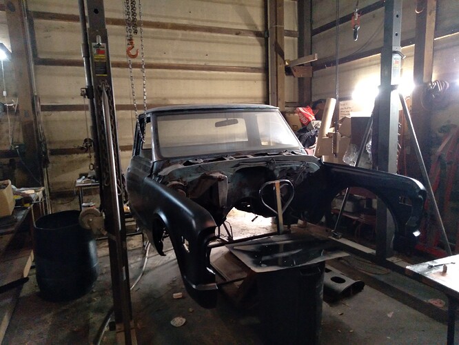

So I have pulled the cab off the chassis and built a cradle so that I can restore the floor pan. Once I got this on the cradle first task was restore the exterior metal so that it will have as much integrity as possible before I start cutting out the interior floor pan and floor supports.
So that is where I started I replaced both cab corners, rockers and the front lower pillars of the cab with new metal. I deleted the hole for the fuel filler neck and pulled out all the dents and restored the back side of the cab. Apparently this truck was rear ended at one point in its life and shoved the box into the back of the cab. So I have that restored along with new doors and front fenders installed for alignment and also to add integrity with the door closed and latched to keep things in alignment as I reconstruct the floor supports. So for now I am going finish some sanding work and primer it to this point. There will be lot more body that will come later but I want to get the new floor reconstructed first before doing the finishing body work.

I decided the change up the paint color I was going to go with an off white but since its the Doomsday Chevy Project now it sort has a theme now. So Im going to go with a semi gloss urethane black paint. Im planning to build a custom fab flat bed with a teamed gasifier system integrated directly into it. It will have integration for tools for wood processing on the fly along with a kiln. Planning a small 24 DC generator system with LifePo4 battery bank and 5 kW inverter for running this equipment (electric chainsaw and off grid power general use.
The primer coating on the fenders are pretty close the what the finished coating will look like. More to come stay tuned :fire:
