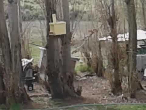

Scout Bees are checking the hive out.

Maybe the scout bees like the flake board “camo”. I have also heard bees from your own hives want to swarm a fair distance away from the mother hive, like a few hundred feet or more? to lessen competition.

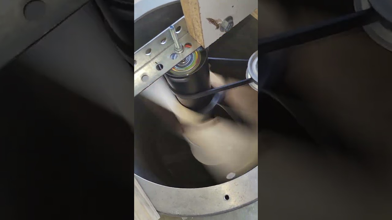

Just save myself more than a $1000.00 building this.

it looks good. You will want to look for another freezer basket or some wire to extend the basket up the full length of the frame. The basket is to help hold the comb in the frame when it is spinning fast and loaded with honey. The comb will pop out of the frame if it is spun to fast.
It will also make flipping the frames over and putting new frames in the extractor a lot faster.
Be thankful for the motor, we hand cranked ours the first year… :slight_smile:
Actually I thought about it while driving, and you may not like this because you did a lot of work with the basket already, but you could undo the basket and you have two halves that are long enough to cover the frames, then ours had flat stock frame that attached at the 4 corners at the top and bottom. There was maybe a 1/2 gap between the tank and the corner. There has to be enough space to get the large super between the X it makes. and you want the frame as far out as possible.
The OTHER thing is, because it is two frames, it may shake a lot because it isn’t super well balanced. You may need a counterweight or feet or someway to clamp it to something else. Ours shook with 2 frames, but it was wider and more pronounced because it was a 4 frame version.
Sean, with the larger Langstrough/Layens frames I have a clamp that goes over the two frames at the top. They have plenty of clearance from the wall when spinning. I can also put any size langstrough frames in the basket small, medium, larger.
Granted this is only a two frame extractor spinner. But it will be a lot faster then gravity dripping or crushing comb and draining through a strainer. I do have foundations for the honey frames and for the brood I have nonfoundations frames with wire for my brood frames. All my honey exstraction frames have foundations with wire supper strong.
I was spinning the frames at high speed with no problems. This is a lot faster then is really needed.
We used to spin them out even with the hand crank, but our foundations were wax with wire. But they were going fast enough they were flexing. The closer the frames are to the more force that gets applied the faster the honey comes out. It will be faster then the other methods for sure and you probably aren’t trying to do 15 supers in a day.
I have right now 4 medium frame supers and two 31 frame Langstroth / Layens long hive boxes. Harvesting honey for family and friends.
