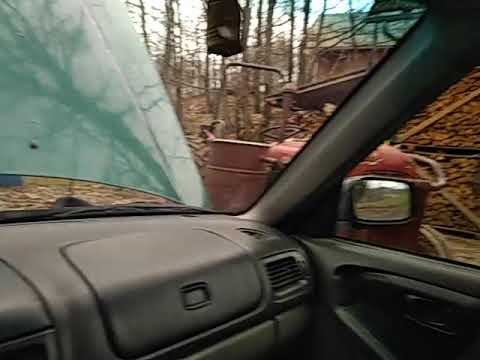

I was able to control the wood burner even after it jumped out from under the seat ![]()
Pretty sure that itās a Morey eel, Don.
Driving in place, sorry, that doesnāt belong in this thread. Subaru loves wood gas, but itās hard to adjust the mix ratio with adhesive tape,ā¦
Now thats what good gas does in an engine⦠if it aint redlineing im not satisfied. Excelent.
What year is that Subrau? 2.5 L engine? I am working on a charcoal gasifier hook up for mine on the back bump. Mine is a Outback 1996 year OBD 2 2.5 L engine. Yes what Kristijan said.
Ha, I donāt think Iāve ever dared to rev above 4000 rpm, not to implode filter containers and such ![]()
It would have been even more interesting to see how the Subaru reacted under load. A complicated experiment though ![]()
Is the new gasifier of yours ending up on the Subaru or the pickup?
Me too. Tone did shave the engine head off so the increased cr shuld give excelent power
JO, Bob, Subaru is a 1999, 2.0 l engine, it has replaced the heads from the 1.8 engine and thin metal gaskets from 1.6 mm to 0.6 mm, so it is CR 1:13, I intend to make a light compact unit that I could install on truck or in the back of a Subaru, empty must not exceed 100 kg and in floor plan 60 x 120 cm, it will probably be in a closed case and forced cooling with a 12V fanš¤
