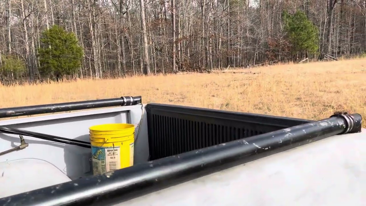

Mr. Wayne, I apologize for asking this question, as I know you have said it a hundred times, well, however: do you have a vacuum reading directly before the throttle body and how much does the resistance reading show - the vacuum created by your gasifier system, filter, refrigerator and mixing chamber?
Thanks, Tony.
Good morning Sir Tone .
I have 3 locations where I measure the vacuum.
1 In the piping between the hay filter and motor throttle.
2 Between the hay filter and gasifier.
3 Fuel hopper.
An example if all is well driving at a cruise speed on level road 50-60 mph . I would expect to be using about 1/4 throttle and showing a vacuum reading of about 10-12 inches of water at gauge #1 , Gauge #2 should read about 5-6 inches showing the hay filters resistance of 5-6 inches . Gauge #3 should read 1-2 inches showing the resistance of the char bed .
Thank you for the quick reply Mr. Wayne, when I did a vacuum measurement on my tractor, the pressure gauge showed at point 1 also more than 40 inches, well, under normal load approx. 15-20 inches, obviously your system has more flow with less resistance, well , I am also very satisfied with the performance of my tractor, and you also have a lot of merit, for which I am grateful.
