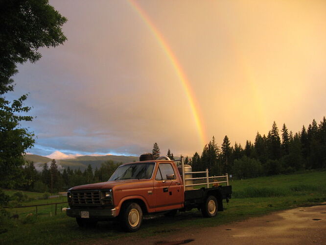

Drove over 30 miles and came back and checked everything over,and the condensate traps and monorator is working well.I liked the steam pouring off the truck as the rain hit the gasifier and other hot parts of the system.After awhile the rain let up and this appeared.

Paul & Wayne, Good picture Paul ! Wayne, until recently I was unable to kill the engine by choking it. This new truck will quit if I get the mixture too rich. We discussed this quickly when your throttle stuck on the old ford but we never did it. I think it is better to pull too hard than not enough. I now am running a second generation OBD2 truck and I don’t dare turn the key off while driving. It has a security system that prevents re-starting. If I want to start the truck by coasting down a hill and popping the clutch it will not run (fuel pump does not run). I have to actually turn the key to the starter position. If I pop start it on woodgas it will not switch back to gasoline as it thinks it has been stolen. It’s a pain in the ars … The clutch switch is also a pain in the ars as there is a time delay on it. Local parade in 1.5 hours … Massive rain system to the west but not moving east too fast. I always go to the local ceremony. It’s a hike up the hill to town. I planted potatoes yesterday. Hiked up the hill to check on them a bit ago. Some deer tracks in the hills. Hope they take a nibble and go yech. It gets tougher every year to hike up there. We abandoned that garden last year but I had a pile of sprouted reds and didn’t want to just dump them. I grew some in a bucket in a south window this winter and got several pounds out of the bucket so it’s worth the bother but I am sore and pooped … Mike L
