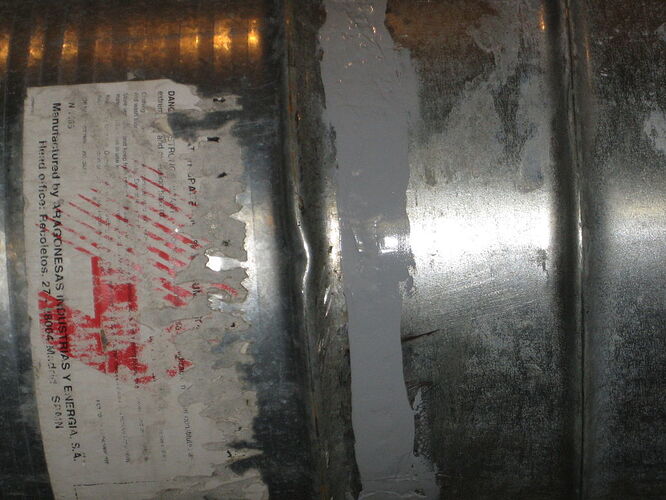

Thanks Chris and Bill for the information. Chris you said Wayne uses barrels that are 16ga, that explains why he makes it look so easy HA HA . I’m sure the real reason is because of his many skills. I am curious where he finds barrels that thick. The barrels I’m finding aren’t that thick. As a matter of fact the barrels I’m trying and I repeat trying to weld at the present time are .030-.035 thick and besides that they are galvanized. These barrels will be for my hay filter. Bill from what I see you live in Ramsey MN. That is not to far from where I live which is Clear Lake MN. I met you at Argos last May hope to see you again.
After many attempts to weld pin holes I resorted to using seam sealer. I don’t know if it will stand the test but all I can do is try. It seemed like I was fighting a loosing battle trying to weld the pin holes shut due to the thin barrels.
