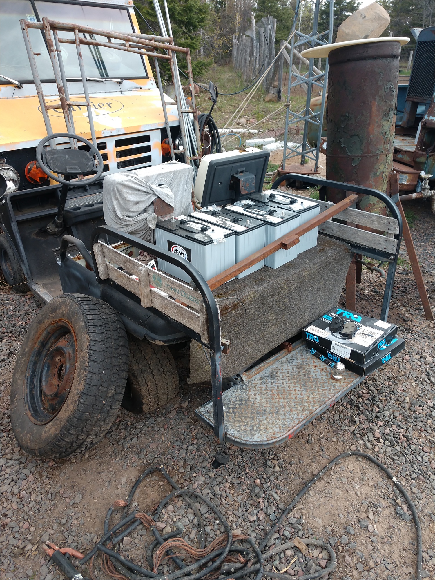

So, I have dreaming about this idea for years. This year I finally got moving. I am building a solar powered golf cart (actually two). The carts won’t be 36v anymore, but 48v. We are looking to mount a complete solar power plant, with panels, charge controller, inverter, batteries, and the wiring to offer power to appliances. The carts are getting the Chinese Curtis equivalent of the 500 amp 48v pwm controllers. For batteries, I am going with the Remy 8A31DTM or 8A31 (dual or single terminal mount) 105 ah AGM sealed lead acid 12v. I can fit four presently, but I think I want 8.

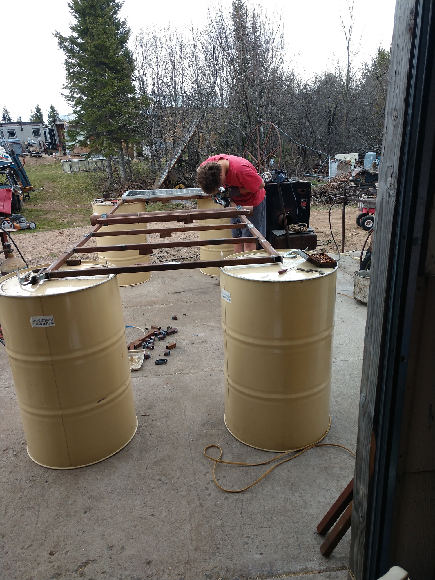

Today we welded a mount for six Newpowa 100watt panels that will fit on top of the cart. We made the mount out of four 8’ pipeline hose reels.
We still have to figure out some sort of all weather electrical box to hold the charge controller and inverter. We have an Outback 80amp mppt which is huge, so the box is going to have to be pretty big. If we go with the Aims 48v inverter, then it will be huge.
Right now we use the Husqvarna E316 or the Husqvarna 420EL on pwm inverters. We have a Jupiter from Harbor Freight, and a Peak from Amazon. These are our 12v wood cutting inverters, and we will prolly have to rewire the batteries on the cart, 48v to move and 12v for power. At least until we get a 48v inverter.
The outback will configure to both voltages so we wouldn’t have to rewire the panels each time.
So I suppose if anyone has a 48v inverter recommendation, we would appreciate it.

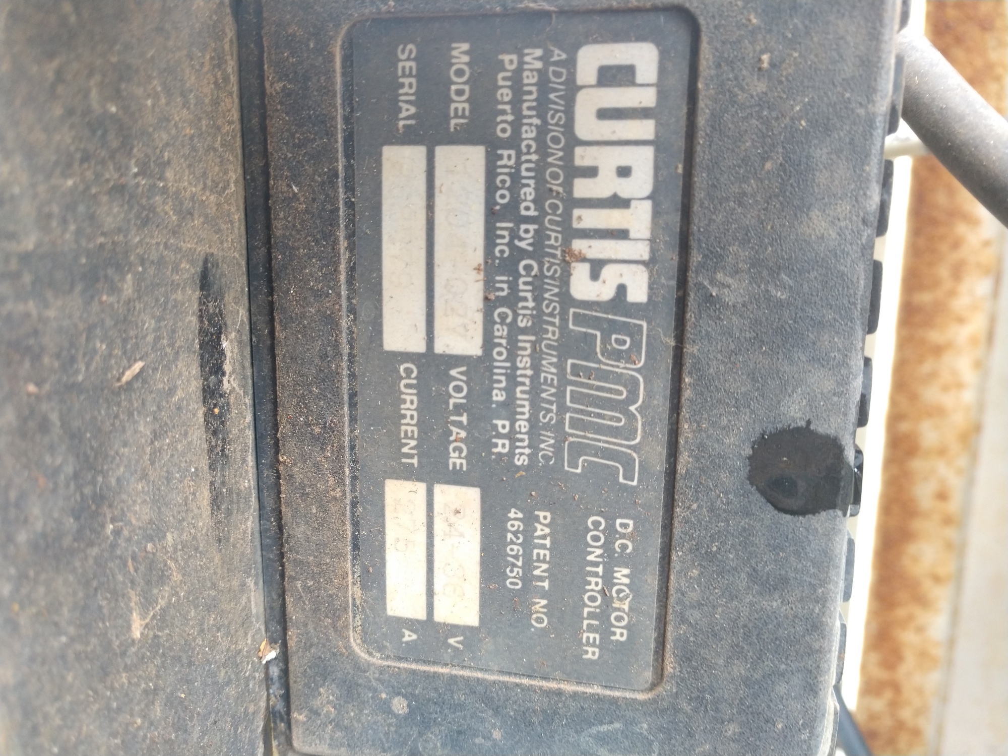

Actually, yes. There are two carts. An EZ-Go and a Melex. Both ran on 36volts DC. The Melex is a Polish cart made in 1952. It has resistors for speed control… very inefficient.
The EZ-GO has a Curtis motor controller, that appears to be pulse width modulated (PWM)
We determined that the Curtis controller had failed. I found a Chinese replacement 500 amp @ 48volts DC for $150.
We also determined that both carts have similar motor wiring. We tested them with 48v direct, and the motors did fine (we had fun too).
We are going to take a leap here and assume the Chinese controller will work on both carts.
What we don’t know is if it comes preprogrammed from the factory. Curtis controllers had to be programmed in the field.

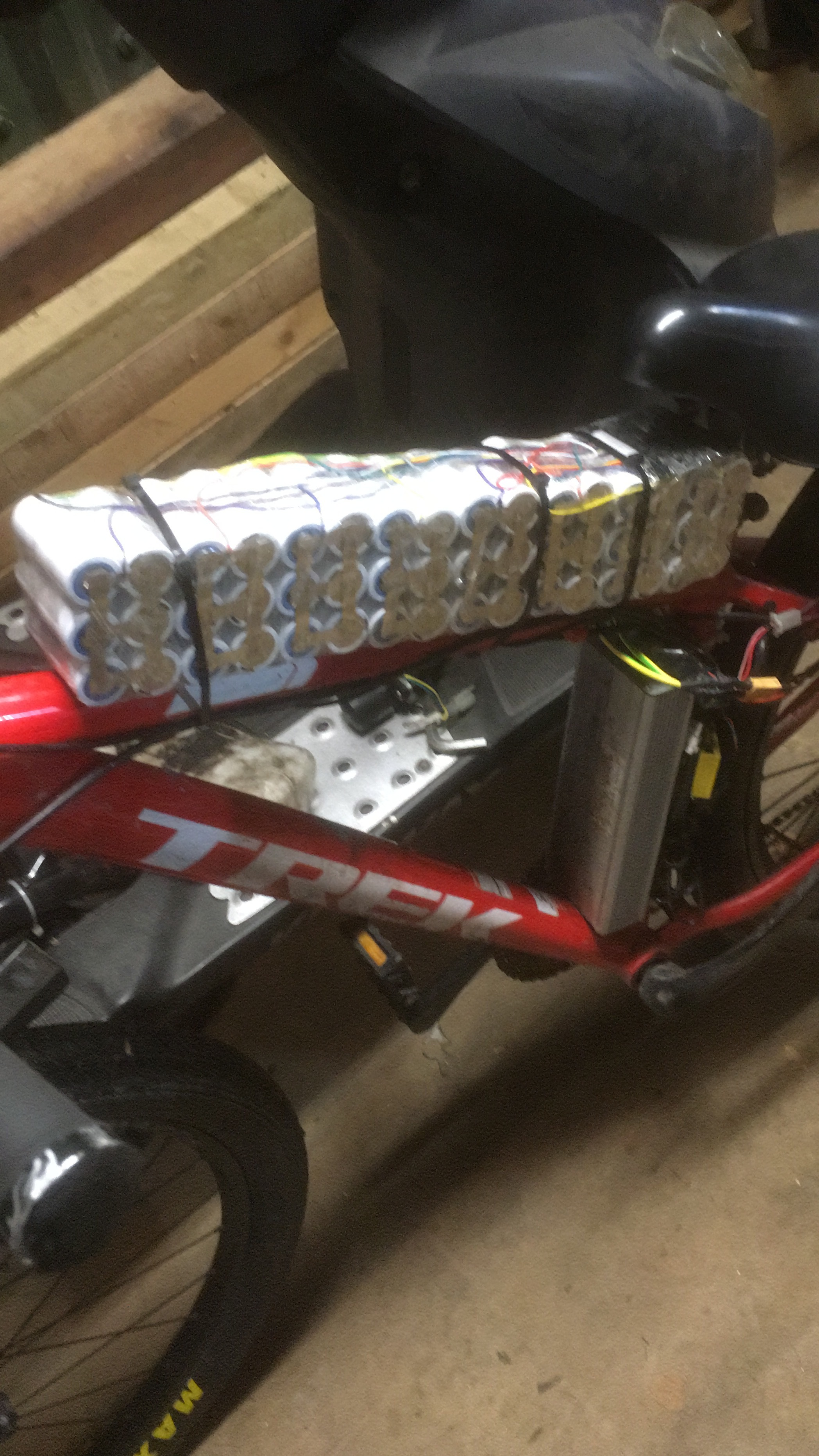

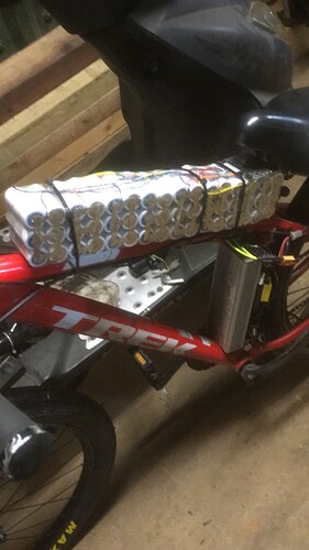

For me too, learned a lot last year and still lots to learn. Lion is out after one cell exploded for a reason we still don’t know. I was already sleeping, the middle sun (who build the pack) was watching TV, a big bang, I woke up angry because I thought someone was smashing doors, the youngest was in panic, smoke everywhere, fire alarms on every floor, by the time I got out of bed the pack was outside. End of Lion for us. He build a new pack from batt hookup 28-650 LiFePo4. Let’s see what that brings.
Range is super, topspeed he doesn’t want to tell. We all know what that means… testride by papa.
And we ordered a diy 90 Ah prismatic pack for his little fishing boat. I don’t want to have him tow the lead acid around. Big trouble with the chief.

It is 48 V and last time over 40 mph/ 72 km/h, a little to fast
Me too, but electric surprises me. As long as every wire is connected it functions.
If the pack gets out of ballance one cell will over voltage and can burst into flames. You definitely need a BMS with lithium batteries. Lifepo4 won’t bust into flames they will outgas nasty smoke when abused but more likely you will over discharge them and cause them to fail they really dont like being under voltage from what I have read. My plan is to build the lithium ion into surplus 50 cal ammo cases the metal case will contain any fire should the BMS fail. I would use Lifepo4 if I could afford it much better technology but the cost is higher than salvaged cells and my project just wouldn’t happen at those costs.
With lithium ion you also need individual cell fusing. It is now available from battery hookup as part of the nickel strip. That was a game changer for me. I have looked into it in the past and didn’t want to do it without known fuses. The pick the right length of wire method didn’t sit well with me.
And I’d think the heavier AGM’s would give you better low down anti-tip over ballast weight.
Putting up a large flat plane “sail” on-board, gotta’ start think about sail boat dynamics.
