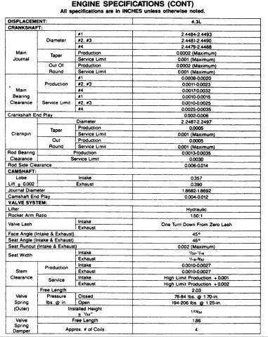

I have the motor in the truck,4.3 chevy rebuilt,and used 1 thousands under sized bearins,with out checking with plastigauge,in the first place.I have 1.25 thousance on one main bearing,the rest of the rods and mains are 1.5 too 2 thousands clearance, I read at arc raceing oil clearance that if your clearances are in the tight range 1.5 thousans,then run thin oil and if your engine oil clearance is in the loose range 3.5 thousands then run thick oil. thick oil wont work with tighter clearances. ARE THERE ANY GEAR HEADS OUT HERE THAT HAVE THE FACTORY SPEC ON OIL CLEARANCE 4.3 chevy engines,rods and mains.1991 astro THANKS

.001 to .002 is about the norm for those engines, but when you have clearances that small you want to be sure the rod journal , main bearing journal & main bearing line bore are with in spec. ( meaning rod & mains are perfectly round and mains are in perfect alignment).
I am sure the oil recommended by the manufacture would be just fine ( up here we would use 5-30 weight).

Hi calvin radar, Well i have a few mains at .001 not counting the oil behind the bottom bearing, The rods are .015 too .002, like you say it may be a little tight on the mains, i gess for raceing motors they like at least .002 too .003 .so since i aint pushing 8 or 9 grand RPMs, it should be good with the thiner oil,THANKS. PS how is that wood gas camper doing on MPG.
