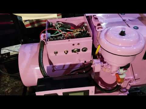

On another forum I noticed some guys watch out the windows with glee waiting to see if the lights will go out so they can fire up antique lighting sets they restore and talk about like they are children ( not me I am not quite that far down the rabbit hole ). Nope year after year when the lights go out they seem to come back on before I need to start to worry about stuff and I hope it stays that way.
Hello Kitty Onan AJ

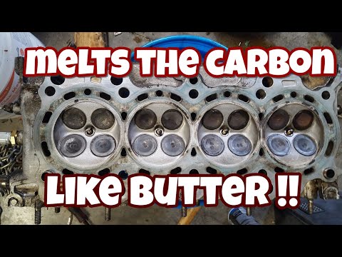

Did you watch the Project Farms video comparing Ethanol to non-ethanol? That was interesting. Especially where he dumped water into the ethanol and it bonded to the water and could be drained out the bottom. I spend over a dollar a gallon extra here to get non-ethanol gas and it is required by the manufacturer in my Troy Built snow blower and I don’t remember if it is in the log splitter but it definitely makes a difference in my chainsaws.
Decarbon…
methylene chloride
OMG its evil stuff but I spray it in combustion chambers install the plug and let them sit one hour before restarting the engine.
I am not sure you can even buy this anymore.
Glad to know we have some project farm enthusias in the crowd love his content! :+1:
Here in Washington you can still get chemdip it’s works fantastic for the garage guy doing his own work. I prefer the giant industrial carousel steam cleaner for cleaning parts myself but sadly I don’t work in a shop that has one anymore :roll_eyes: back to the solvent tank and lots of eg…elbow grease
Unless this has been reformulated for your market it still contains methylene chloride.
Its truely Satan’s saliva, concentrated evil in a can, but man does it ever clean heads and pistons ( and removes paint too ).
I have a can that I only use to do one thing…
I spray it in spark plug holes on engines ( Usually flat heads with a tendency to run on or ping ) let them sit an hour ( no more it will eat aluminum if left too long ) and fire them up. Most carbon will break up and burn off after that treatment.
