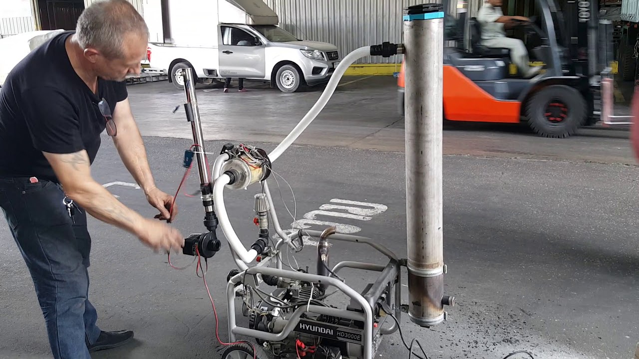

The 50 Kwh build is on the slowed down lane, the boilers are in the fast lane and the activated charcoal somewhere in the middle…
I think i can shift my focus back to the gasifiers end of february… but they are never out of my mind…

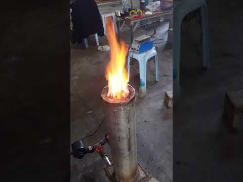

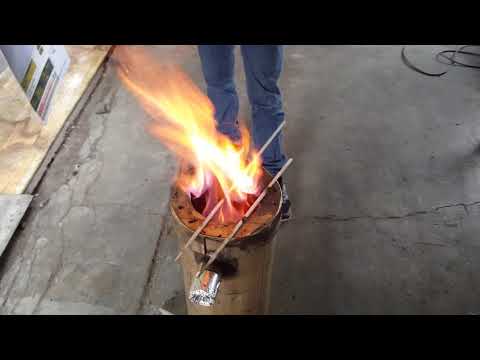

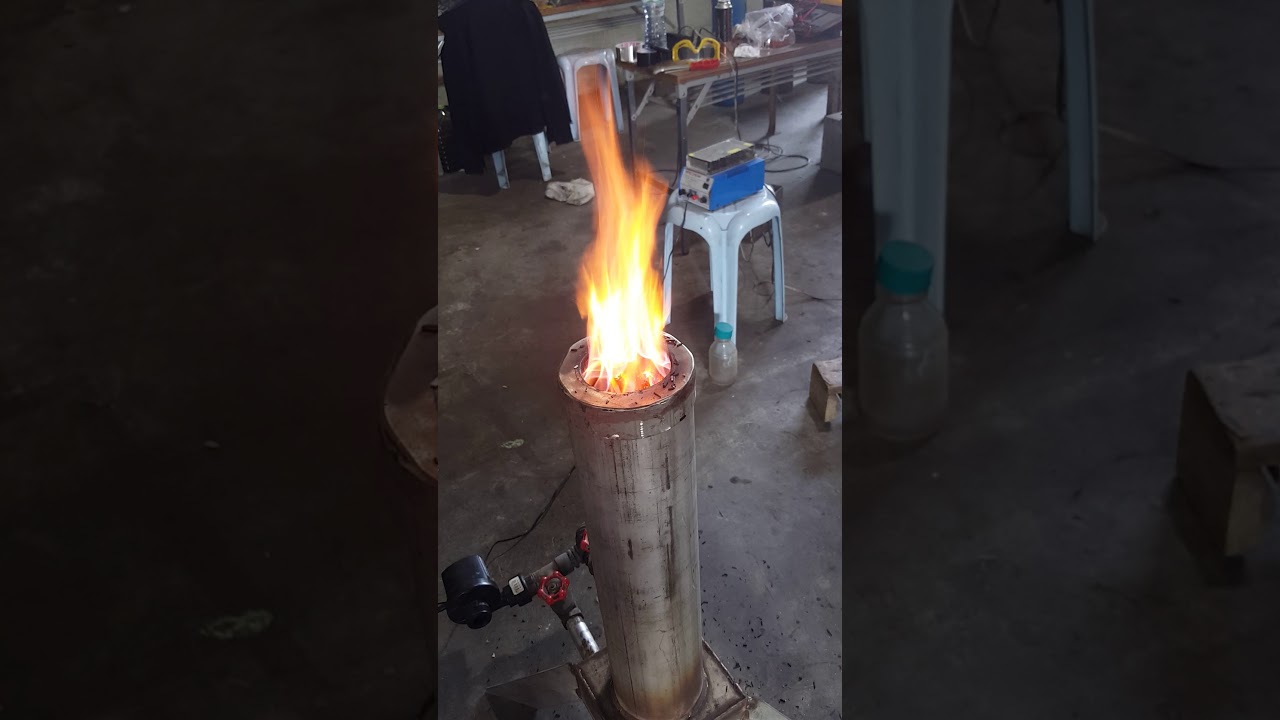

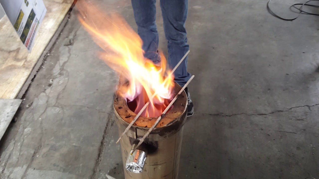

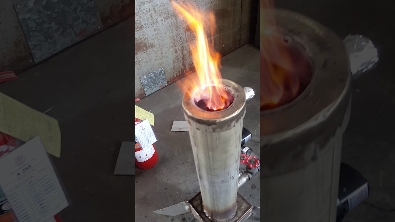

Also the “smart farmer” TLUD stove doing well, works best with some charcoal on top for starters.
Its actually a Fema standing on its head :grin:

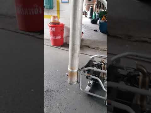

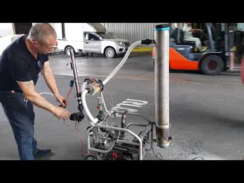

With clean charcoal, start the engine in less then 15 seconds after lightning the gasifier…
The are where i am is open and vented on the top, roof about 10" above the wall and 2 giant doors with only wire mesh.

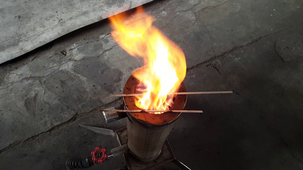

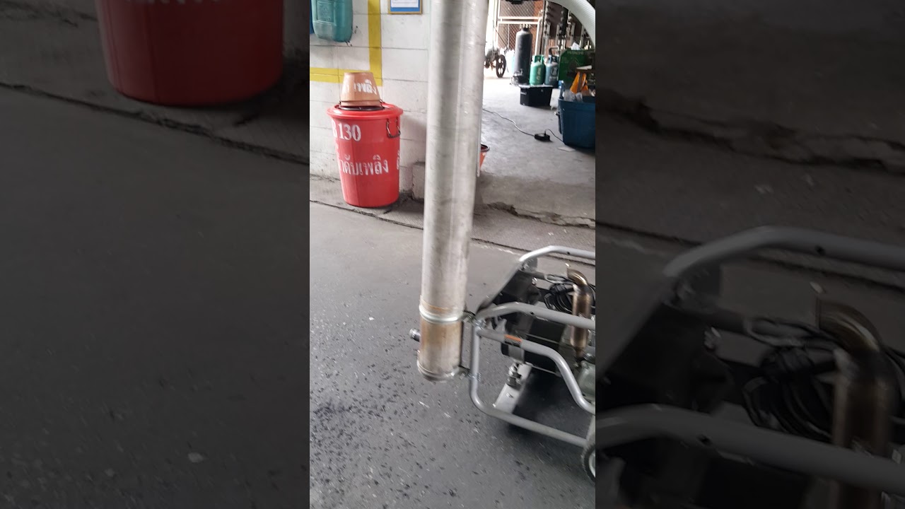

The Smart farmer cooking set, based on an upside down downdraft gasifier… to be the template for further development.

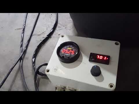

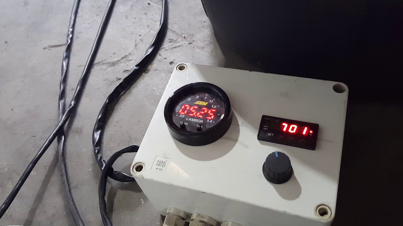

Testing combustion , air to fuel, oxygen, flame temperature…
This one shows O2 % and temp

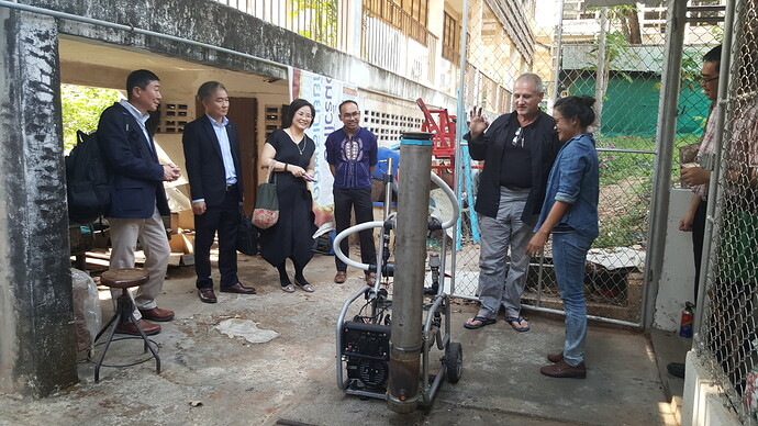

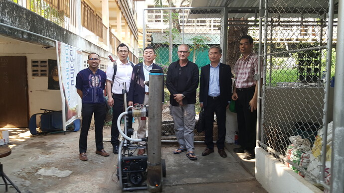

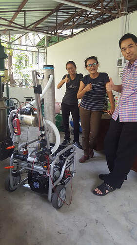

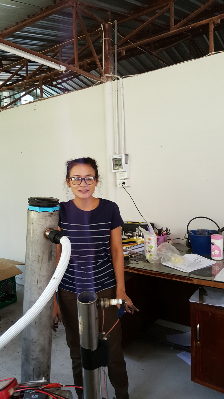

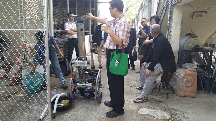

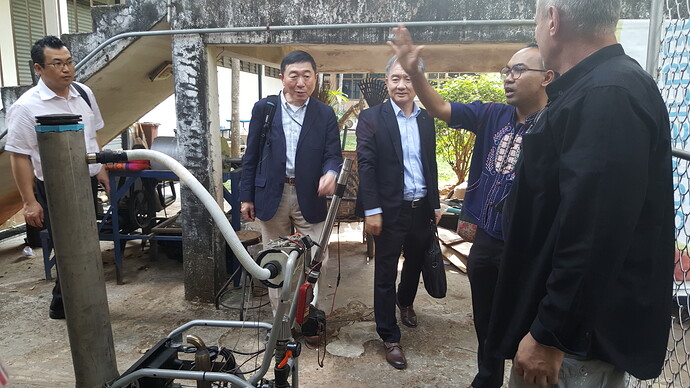

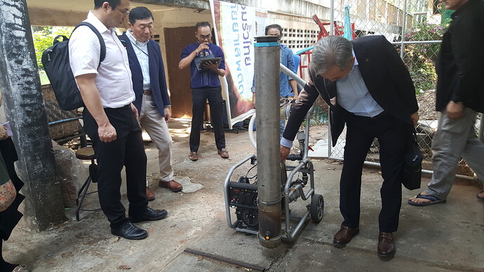

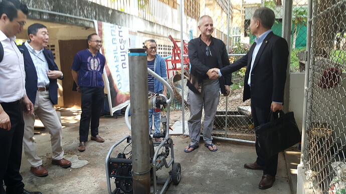

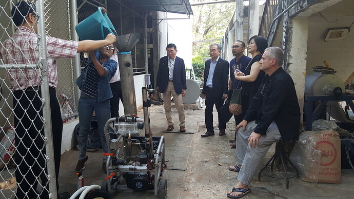

I have donated the gasifier set to the Khon Kaen University, department of Environmental Engineering.
One of their students is going for her Phd , based on the technology we developed…
In the pictures also a visiting group from the Japanese Nagaoka University of technology… a lot of professors to see a simple fire based gasification system…
time between lit the gasifier and start engine: between 20and 60 seconds…
