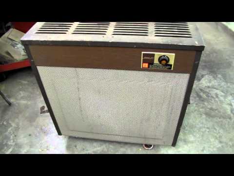

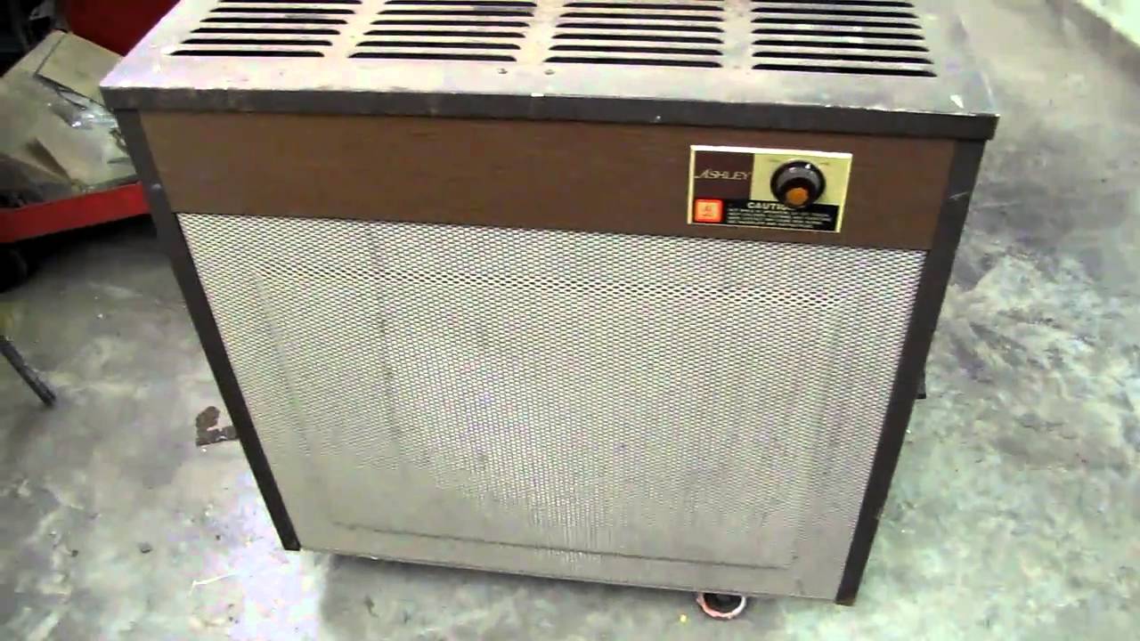

Hi BobMac,
Thru the winter of 1969/1970 we central living room heated and old farmhouse in my H.S. junior year on coal with an earlier version of one of these:
Dad with an old 1950’s Dodge pickup truck would bring home a ton of anthracite? coal from the old Vancouver Coal and Ice Co. passing thru from his trucking job in Portland Or.
I’d have to shovel that off into a crib made up of boards lined shipping pallets.
Then bucket at a time into the living room.
I remember it was started up first with cedar splits and newspaper.
It stank up the house until it got up good and hot.
Had poor low firing/heating capability.
Wanted to be ran hotter. Continuously fired.
Which burnt tru the coal.
The following years we used it instead with wood. Firebox was a bit too small for bulky fir wood.
Later decades of using unshielded no-covers wood stoves taught me you could heat better with naked glass front true woodstoves using much less wood.
I figure these made sense back in eastern states areas coal-land.
Not so good out here where the coal has to be railed in across the country.
