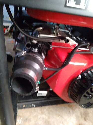

Today I did a 2nd test run of my charcoal gasifier.Its a simple fire made from a 16 gallon drum with a 1 inch inlet and outlet. It ran my 7250 watt predator well for 15 minutes before I shut it down.
One thing i cant understand is how i am having what feels like constant positive pressure coming from my intake ball valve with occasional exhaust fumes, instead of suction. My cloth filter going into the intake was even slighlty burned.
The 1st test ended after 2 minutes with a small part of my foam filter coming apart and blocking the intake. I removed the blockage from the intake today but wonder if there could be another piece wedged farther in? Seems unlikey.
Basically i am wondering how my engine can run so well with exhaust coming from the intake? Is this a problem, what is the cause? and how should it be fixed?
Its almost like the intake is pulling air in and pushing exhaust at the same. Or alternating between vacume and positive pressure within each cycle of the engine. Doesnt make alot of sense but i have slight vacume at the intake of the gasifier and its running so it has to be.

Pulsation is normal on a intake manifold but smoke is not. If it was a leaking valve l dubt it wuld run so good. Does the engine maybe have a crankcase vent in the manifold? It may be piston blowby thats showing as smoke.
Thank you for the response. I was not aware that pulsation was normal just knowing that makes all the difference.
The engine has 2 vents. If I am thinking right one is a tank vent. The other vent is most likely a crankcase vent they are both currently unhooked from the carb.
The exhaust that i saw could have been small amounts of char gas being pushed out the intake as well. That would make more sense now that i think about it. I will have to do some more test to see if my gas was to hot and if that was the cause of the filter burn or if it really was hot exhaust.

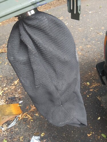

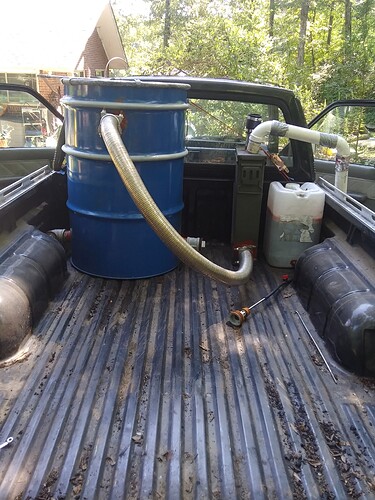

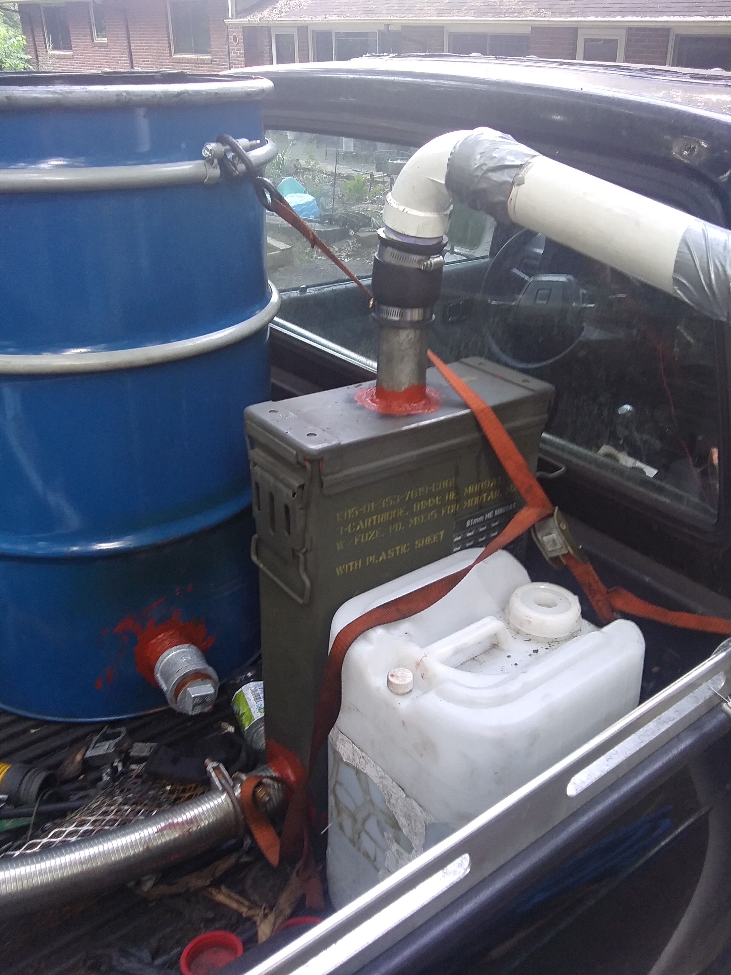

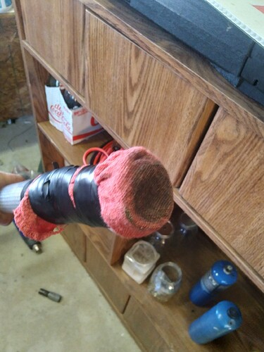

Taylor can you take a photo of how you have your filter set up?
What Cody sayd. Good chargas shuld have no colour whatsoever. If its visible it either means your charcoal is wet (bad) or tary(wery bad)

The last picture with the red cloth is inserted into the into the intake in the first picture.

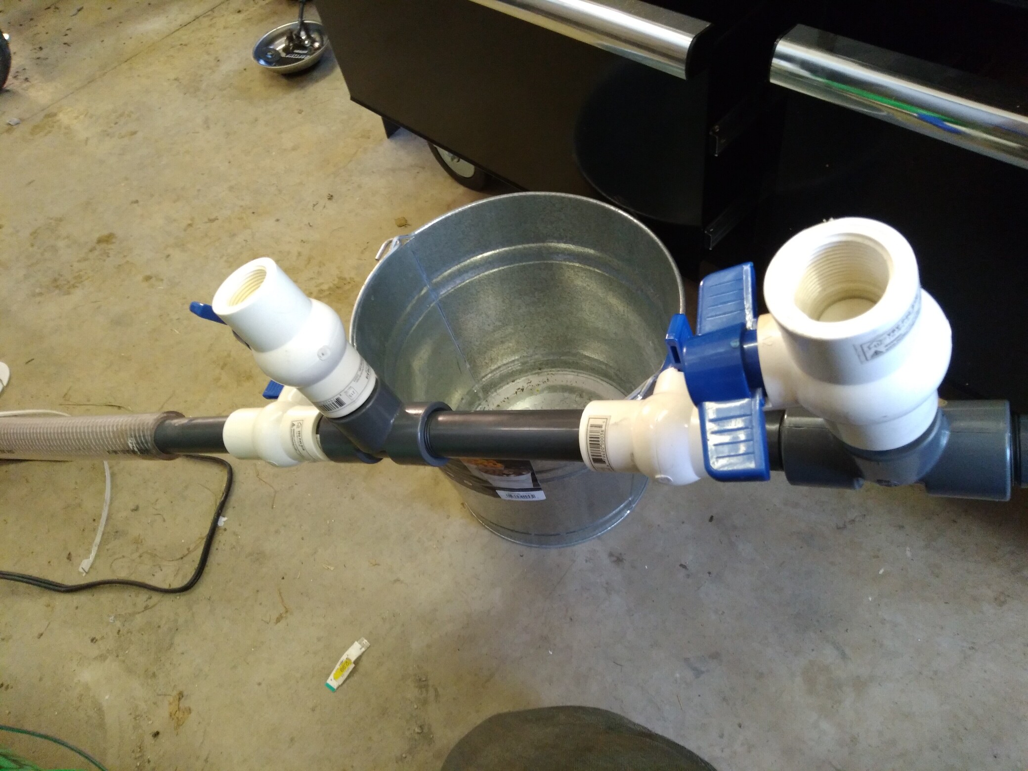

I have 2 set of ball valves so the engine can be run on gasoline while the gasifier is running without stalling the engine. The reason i have done this is because i transition to chargas by shutting off the fuel shut off vavle .It takes about a minute to start running low on gasoline. If the gasifer is making alot of gas already it will stall the engine if i dont wait for it to start running low on gas. I realize i could start the gasifer through the suction of the engine but so far i have let my unit get warmed up before trying.

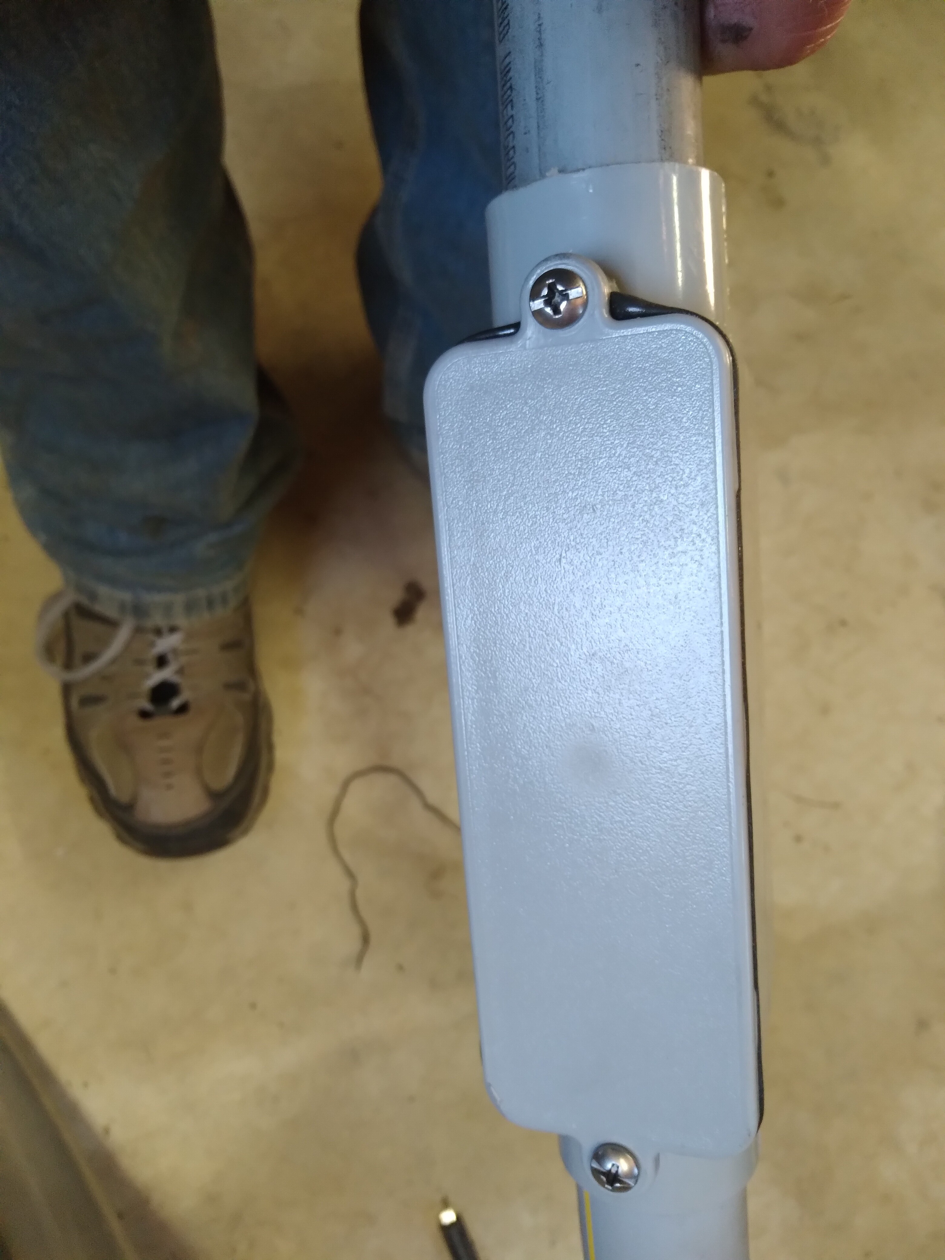

The picture with the junction box has a foam filter in it that is posistioned before the ball valves.
Disregard the second picture it was a mistake.

Hi Taylor sometimes its very hard to understand systems from photo’s it would have been nice to have seen the gasifier and downstream system set up , so i will just mention what i can see from the photo i did understand , the red cloth on the end of the pipe that you push into the air intake of the carb , is no good at all , for a few reasons one is that the area you are filtering out is very very small and will soot up very fast , do you have a filter box before it with finer material in it ? if so then just use that , also if soot and small particles get into your engine it will foul up your valves and they will not seal as they are meant too and yes you will get back fires and that cloth will maybe singe or worse still get sucked into the engine .

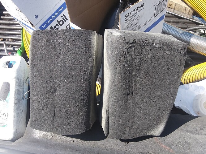

I’m not the biggest fan of a foam filter. I’ve tried using them and they just clog up and the soot creeps around it.

Is the cloth filter still bad if that is a secondary filter that cannot get sucked in? I have a foam filter before it. Or does it just need to go all together?

The problem with that cloth filter is the surface area is too small.
If you wanted to make a cloth filter sew up a bag from towel material or cotton canvas. For that engine I think a bag about as big as those reusable grocery bags would be a good size. It would need to be inside a box.

Here’s what foam did in this same filter box. Clogged and then slipped past. Lots of carb cleaner was necessary to unclog my jets.
