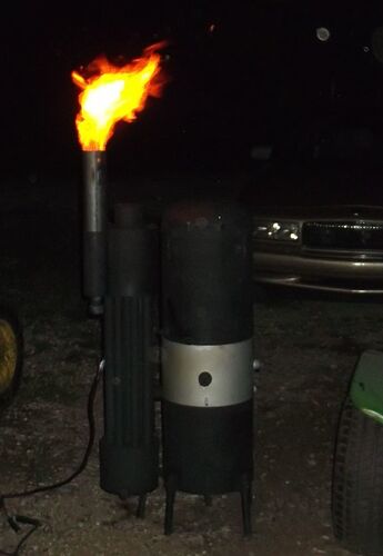

OK here is the very first flare off, of the new M-Series II gasifier. This is the gasifier that Im planning for the tractor conversion. Im going to run it for a couple days and mointor the flare and see what happens before I make any adjustments.
Looks like the build is ticking along nicely
looks good Matt

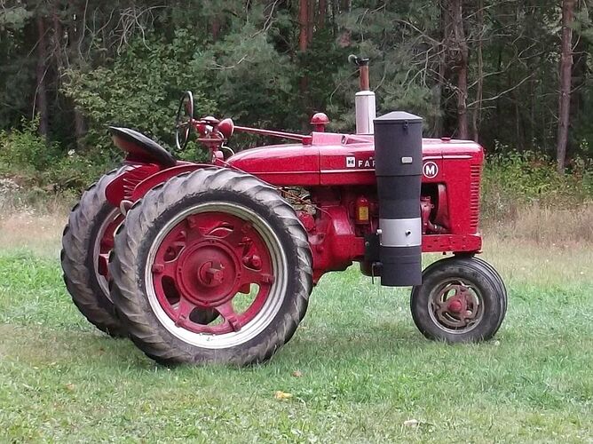

Im getting closer to actually mounting on the gasifier. Im hoping to have the M-II mounted on tomorrow. Im building my own lid for this one to see if we can do it. I have to finnish up the seal and I think Im going to hinge it on the machine this time. Im going to relocate the condensate troft to the hopper instead of building it into the lid and will also enlarge it a bit. I also enlarged the hopper for this build and will offer this machine with this hopper as an option. As soon as we can get the gasifier mounted then we can start fitting on the new filtration system ![]()
Matt, what kind of run time are you expecting with a unit this size? What size fuel is this designed for? Looks good so far.
Don M
Id like to see an hr run time out of it, but we wont know till we fire it up. This will be my very first large engine build. Yeah I think this is where HP is not a very good way for sizing a gasifier. The engine is about 230 ci and makes just 30 hp. So for this build I developed the M-II that features a 12" heath with a 4" restricter. So it should be able to eat up just about any thing. The first M-II I built ran some pretty large chunks with out issue and after running it I thought it was pretty impressive. I ran it for about 16 hrs and the flare cleaned up really nice and it ran very consistent.
The grate spacing is 3/8. The Hopper is 14" in diameter and is about 30" tall from 4" above the jets. So if run times are to short then I guess we just build a bigger one
For the filtration I decided to convert my existing condensers to liquid cooling. We just built a water jacket around them and will have the radiators in between the two. There will also be two hydro clones one after the gasifier and one after the condensers. Then we will have a mixer dryer and possibly a media filter.

Ok I got it mounted up there. Yeah I spent a whole day trying to figure out a new puffer lid design. I ended up going to a simple 12 dollar cam lock latch and hinged the lid. Ill just simply put a blow back plate in the lid.
But any ways it will really start to come along this week. The filters are mostly build now just a matter of putting it all together.

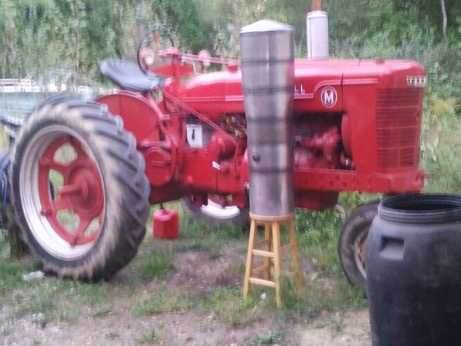

Matt, I’m just skimming here. I think I saw some of your stuff in Argos last year. A “young” fella was hiding in the shade of a building there with it. It looked very well built but was too small for anything I run. The hopper on your late september pictures would be good for around 10 miles or so in a typical car or truck. I suppose it would run that tractor for 15 minutes or so with no load. Take a look at the size of the unit on Ron Lemler’s tractor. He has many miles behind him now. I have built many units that are good for the typical 20 mile round trip drive and have also built units to do the 60 or so miles between fill ups. Johan has a video on his site vedbil.se somewhere where he runs his tractor into the woods to cut more wood for his tractor. He was using a gasifier he built to power a toyota in England for a movie thing and then he managed to get it back to Sweden but couldn’t register the truck there so he put the gasifier on a diesel tractor that he converted to spark with the gasifer … I’m not sure what he is doing now but my guess is he is making babies or at least that is what I hope he is doing …
