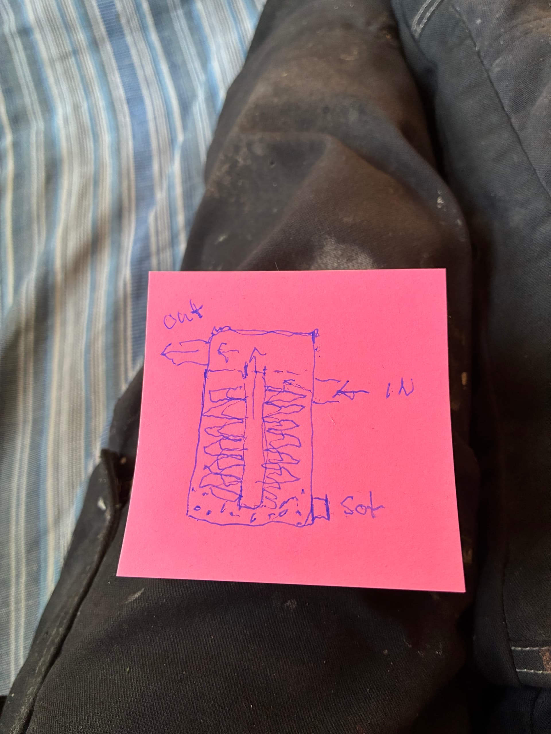

Göran, @Woodrunner a few questions, I talked to Jonas, he had made a fiberglass filter and let the gas in on top of the filter.
I tried the same thing, but get so little resistance that almost everything from the unit ends up in the filter, quite large pieces, like sugar cubes.
I’m afraid that these pieces can burn holes in the filter, what do you think?

Hi Jan, i don’t think the bigger pieces do any harm, as long they don’t hit the fiberglass directly, and have enough space in the bottom of the filter.
I built my filters double-walled, and acting as a cyclone at the same, and it works well. The Chevy draws a lot of big pieces, up to twice a sugar cube.

Ok, put the cyclone back, the carbon stays on top of the filter, the car had a little better power without the cyclone, but no big difference.
