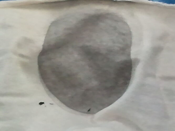

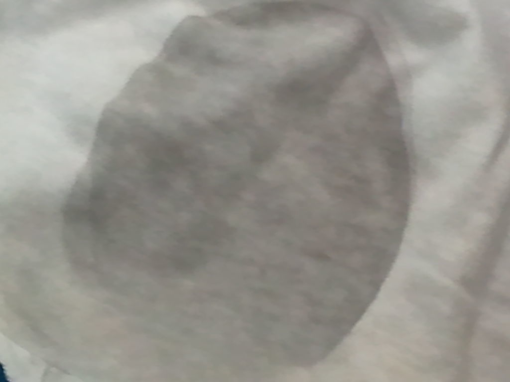

Fixed all my leakes,added some improvements and installed my new filter.Trying pine straw as filter material,made trial run and flare still not blue but good enough.Next step is to plumb to genny.Will not let me post videos from my phone,evidently wrong format. Anyone wishing to see vids, watch my last two postings on youtube(docdcox).Did napkin test over flare nozzle for 3 mins. after appx.3 hour run,two pics showing soot and same spot after blowing off with comppressed air.Merry Christmas to all!

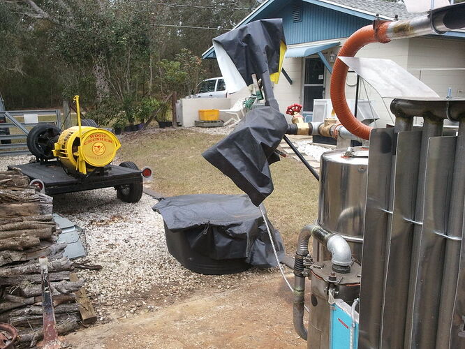

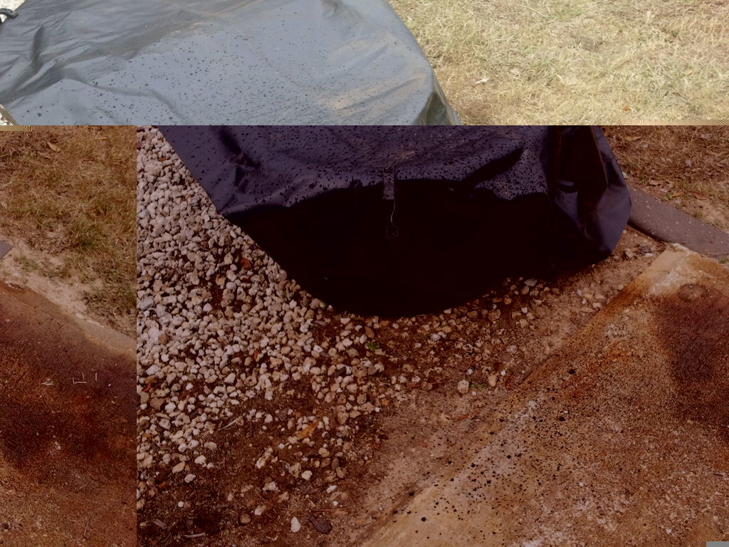

Soot!!! Last night after my 3 hour run i killed the flame and did a napkin test for soot.Posted 2 pics of napkin.I let the unit cool down with no flame while slowing down the blower and choking off some intake air. Last night i noticed i had black soot spots all over my arms and face that washed off with soap and water.This morning i found soot spots all over the ground and object nearby.I had turned my flare nozzle up at an angle so as not to walk into flame and used my new large filter with pine straw as a filter material.I do not remember this much soot before i did this.I know i’ve been told soots not a problem,but this is large amounts.2 pics,zoom in and pan around to see.Thoughts on why so much more now,should be less?1st pic you can see nozzle sticking up and away from camera at an angle(spots below this) 2nd pic spots on ground and tarp covering plastic tub.
Danny; is the soot in the pipe to the burner or just in the burner? If just in the burner it may just burning rich.
Down the pipe too.Im thinking adding this large new filter has created too much of a draw, making the mixture too rich.Plus in the 40’s during run,lots of condensing.Also by turning my pipe upward maybe thats doing something to it.
Nothing wrong with soot. It’s actually a good engine fuel - it will be consumed during combustion. So long as you’re not getting tar, the gas is clean enough to run an engine.
Your machine looks top shelf Danny! Nice work!
I had similar “soot spots” everywhere after early runs. My problem was too much condensate getting all the way through the system. Is your local dew point really low? The Weather channel now has temp and dewpoint posted on the home page for your area.
Make sure your exit gas is below the posted temp ( I suppose?), that would be my starting point. I added a crude remedy to my system, a car radiator. That brought the temp down enough that it filled up with condensate quickly. And I produced much better gas.
Just my thought on where to go with troubleshooting, I bet it runs sweet when the temps are in the 50’s-70’s.
