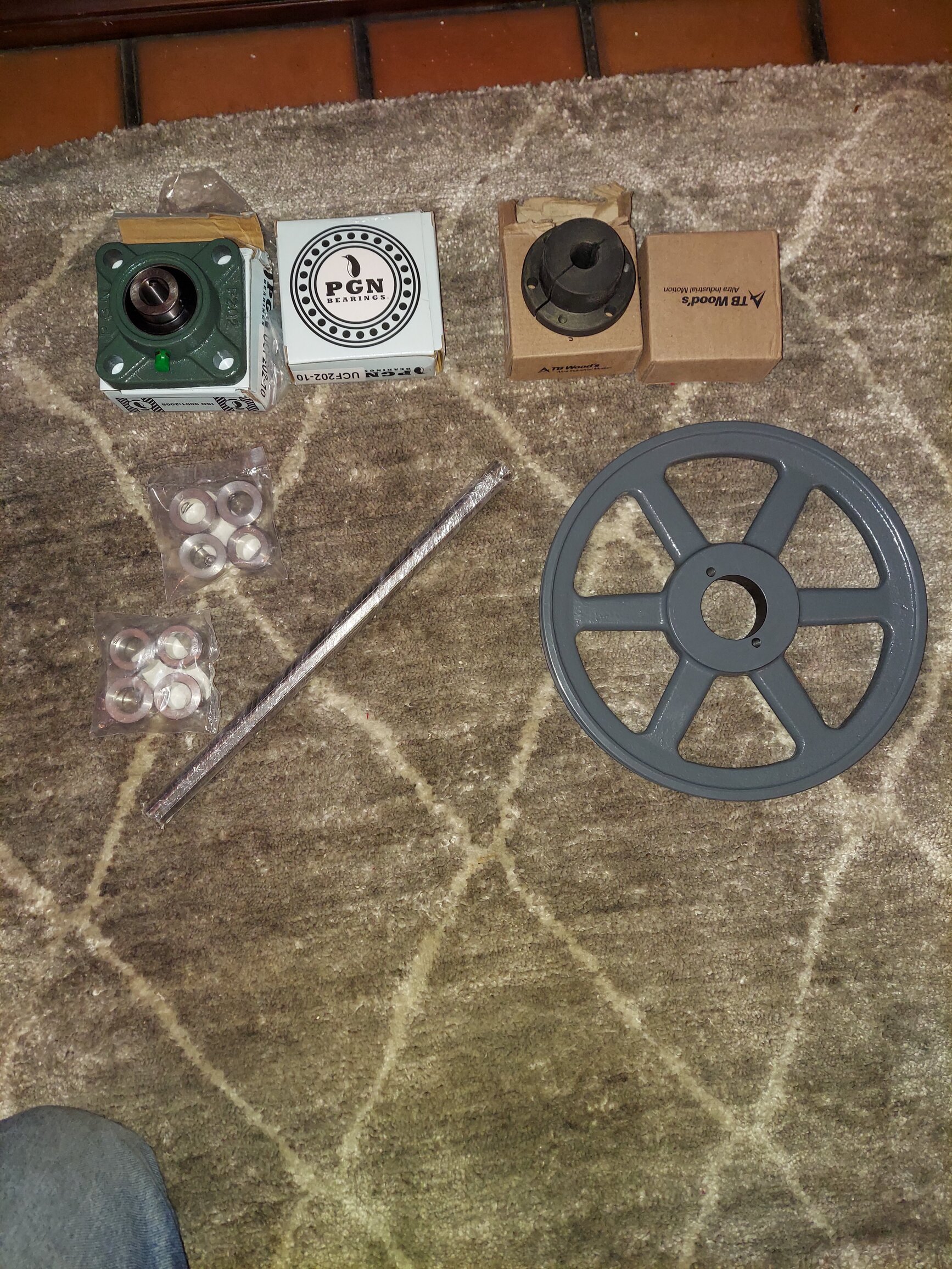

Parts for the grinder arrived in the mail. I still have to find a suitable bushing to fit the flywheel, and a motor pulley. The bushings pictured will be used to secure the rotary grinder bit to the keyshaft.

The low RPM motor was for powering the charcoal grinder. All I was able to scrounge up last winter were fan motors running way too fast for the application.
As far as motors go you could underdrive with a smaller pulley on the motor going to a much larger pulley on the grinder, maybe even go so far as to make a Double Gear Reduction(small to large on a jackshaft spinning another small to the final large) and use a PWM on the motor itself to slow it down depending on the type of motor.

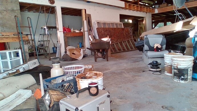

Just got another one somewhere is this clutter of left-behinds (my request) that my darling wife bought for me in this old shop-barn.
Only things of mine so far in there is the ladder, the wheelbarrow, and my guidance coffee cup.
“One small load out at a time. And someday this space will be mine” I keep telling myself.
That was my original intent; run the motor to as small a pully I could fit on a 5/8" shaft, and step that up to a 10" flywheel. I brought all of the bits and bobs into work with me today so I could ask the boss-man to scour the catalogues for a bushing that’d bolt into the flywheel neatly, which is when he offered me a motor from our stock.
