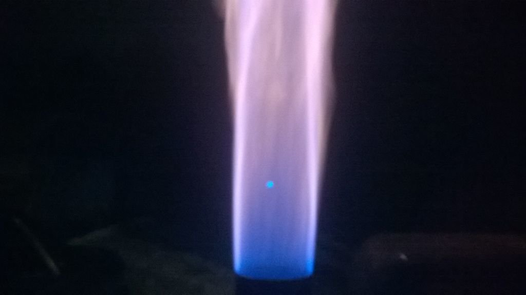

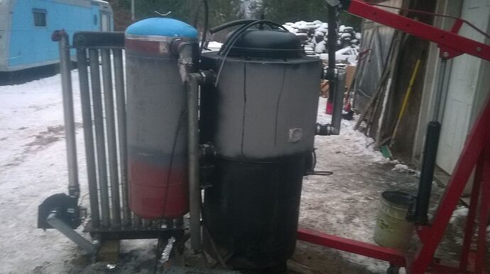

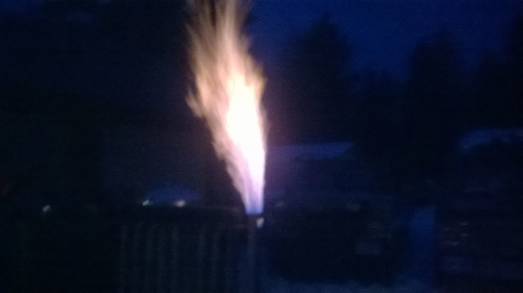

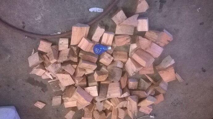

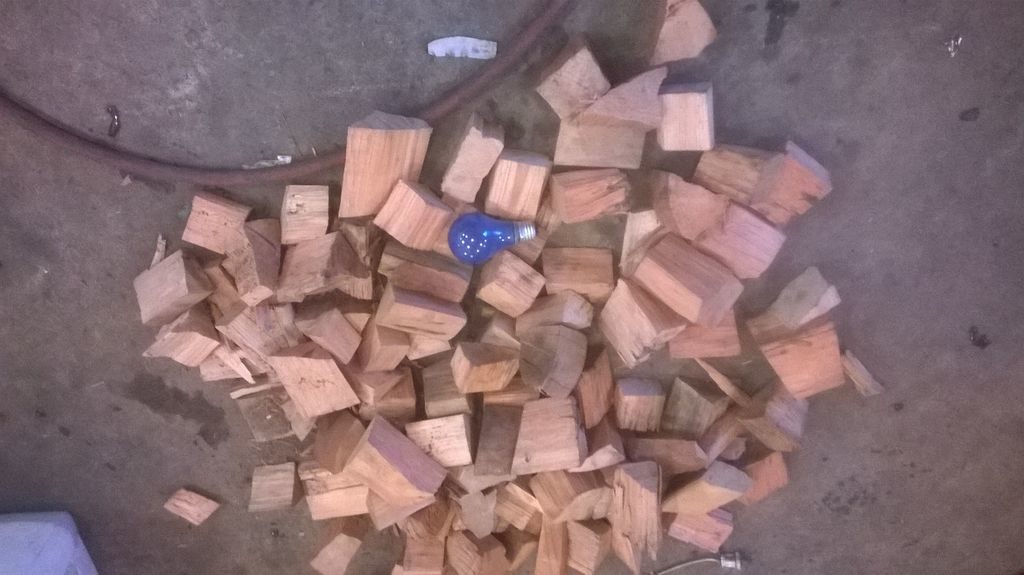

I am pretty excited. I after nearly a year of working on or thinking about working this wood eating conglomerate of cast off things, stuck together with countless kwh of electricity, pounds of wire, bottles of gas, burnt fingers, and sleepless nights . IT had it’s first taste of it’s diet of birch and cherry. details of the guts are on the premium side in an old post titled Jim’s Junk. IT at this time has a 4 1/2" restriction about 8" below the nozzles. her are a few pics of what it looks like, it’s diet and a few pics of it’s first flair. I would love to hear your comments and suggestions . This is my first wood gasifier so I am not sure where to go from here with fuel size and restriction size and location. At this time I am not liking any of my options for a host vehicle but will probably try to run my old Caddy with it in the driveway next. I know the gasifire is a little large for it but it is my easiest to kill the gasoline. It is a 90 fleetwod with a 4.5 liter , 9.5 to 1 cr, MPFI. Enjoy
Good looking flare!
TerryL
Looking good Jim !!
How all the junk that everyone uses to build their gasifier always comes out looking like fine art in my viewpoint. Good on ya
Tomw
thanks guys I couldn’t have ever gotten this far without you! I burned her some more tonight. I let it burn a little without the fan before I closed it up last night , not good. seems she burned up a lot of my char bed. With a little huffing and some stirring I got her going pretty good again. It seems to have a hard time digesting these sized chunks at least with this little power vent fan from a water heater. I have to give here a poking now and again to keep things flowing. I’m not sure the road bumps will take care of that or not. I do have a grate shaker but I think the problem is not enough distance between nozels and restriction also my fuel is pretty big. I would like to burn up to large fist size chunks. from that stack of pattys you see in the pic behind the gasifire…

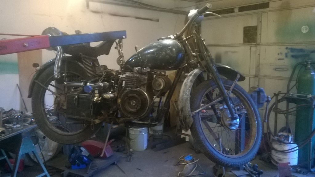

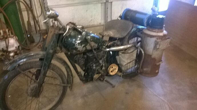

Tom building from junk is my passion. Here is my first simple fire. this one was built using only things I had on hand. I never left the homestead. Not only can I ride it but it is a grate 12 volt dc charging system. It also has a mount to run my junk lawnmower. I only call it junk because that’s where it came from. one mans junk is another’s treasure or art.

That’s a sweet bike jim! I would ride that in any parade.
I too have been building from junk for most of my life. there’s a lot of satisfaction in making something good from what others call junk.
Hey Jim Have you been keeping secrets from us? I never heard anything about a “motor cycle”. That is really interesting to me right now. What kind and size of bike is it? I see the gasifier is mounted on one side and you have a car battery mounted opposite---- is that for counter weight. Does that work. Have you driven/ridden it?
I have a bunch of charcoal in my barn so I started building a Gilmore Simplifier. Got a couple of lawn mowers that would make good candidates, bbbuuuutt; I have a 350 or 305 Honda scrambler hiding out there too. The last couple of trips to the barn, I took a flashlight and scoped it out. I think it is going to get the Simplifier. You are inspiring me TomC
Nice build. Motorcycles are fun, and I’m sure, funner, on charcoal.
Bill all my trucks still have carburetors but my van and it is tbi. The Caddy and Buick are mpfi but not gonna carry this heavy pig nor pull it hard enough. I never dreamed I would be looking for a computer infested anything, my how we change. Thank you Andrew and thank God for the Dumpstore! Tom yes I am guilty of holding out on you guys. The Simple fire was used on an old lawnmower first. I used absolutely no gasoline at all for mowing all summer. Late in the summer I built another larger Simple Fire, Put it on an even older mower, yes guilty again. That is when I put this one on the old moter bike I put togather with junk. It is between a 1948 and 1953 CZ125. That engine and trans came very incomplete in a bucket. I was looking to put it togather with a lil Clinton or something ole and small.I had an old Clinton stuck and missing parts. I knew I had this old Briggs but thought it would never fit. I didn’t turn nothing else up. I measured this old briggs and it was so close to impossible I took it as a challenge and crafted it in there I then knew these two projects had to be merged I did ride it a few miles this summer. It was still at 6 to 1 geared way too high for ease of operation or safety, It still has one original Checkaslavocian tire I machined a new drive pulley installed it. Then I found a leaky carb gasket , pushed it back to the shop and have not touched it since till last week I put ot back up on a bench. still did not get to it I guess it is 8 hp I say do it Tom . From my experience making the charcoal is the hard part, and you have that done Very easy to build and even easier to operate.

If anyone dose build a bike keep your gasifire up a little higher, mine is below the axel centerline a bit. I kept all the weight as low as possible for the best balance but on tight turns (u turns in the road) the gasifire will scrape). This would be very dangerous at any speed. I built this as I did to drive in the staging lanes at the dragstrip to charge batterys on race cars without charging systems between rounds. It has not been taken out in public yet, but will see some promo use this summer.
Yes Carl motorcycles are fun, but I wont’ be going to far or fast on this one. It is more of a mini bike, rat rod style. One of those things a guy just does cause he can.
