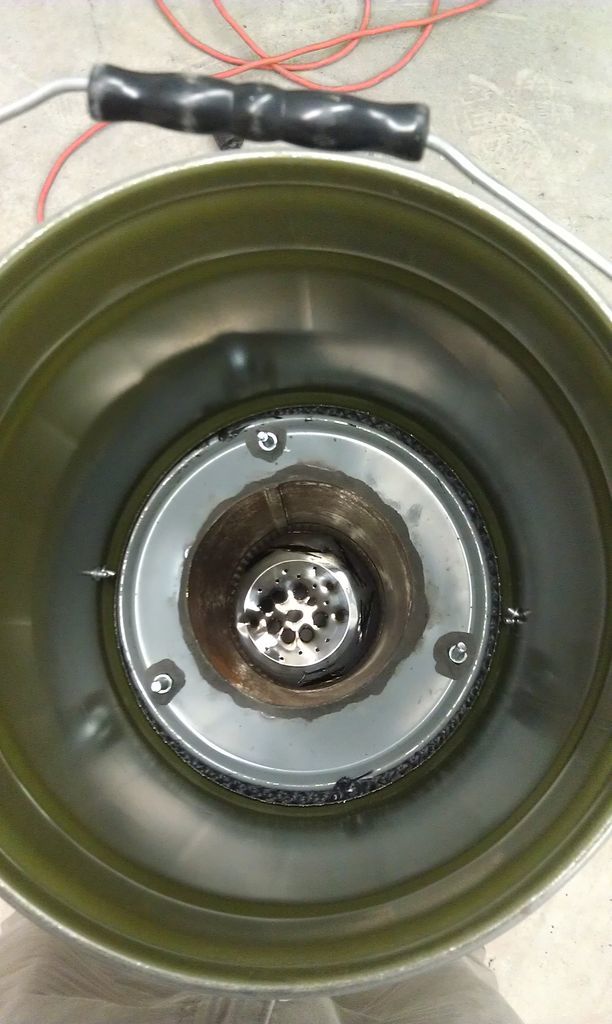

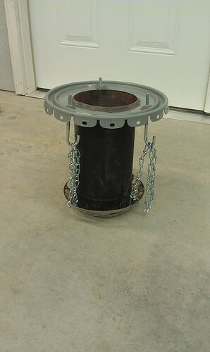

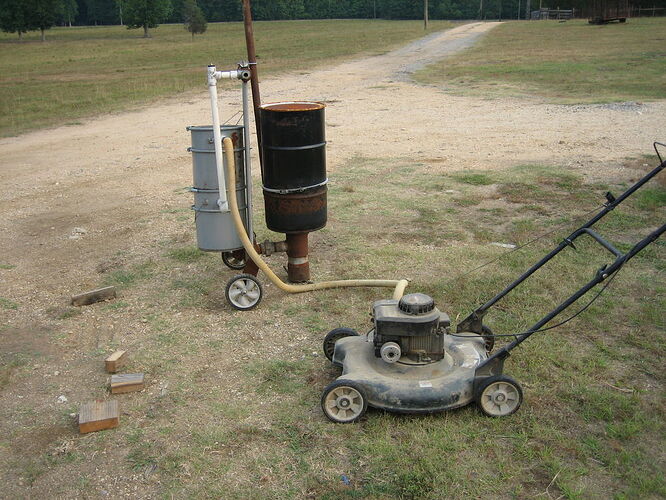

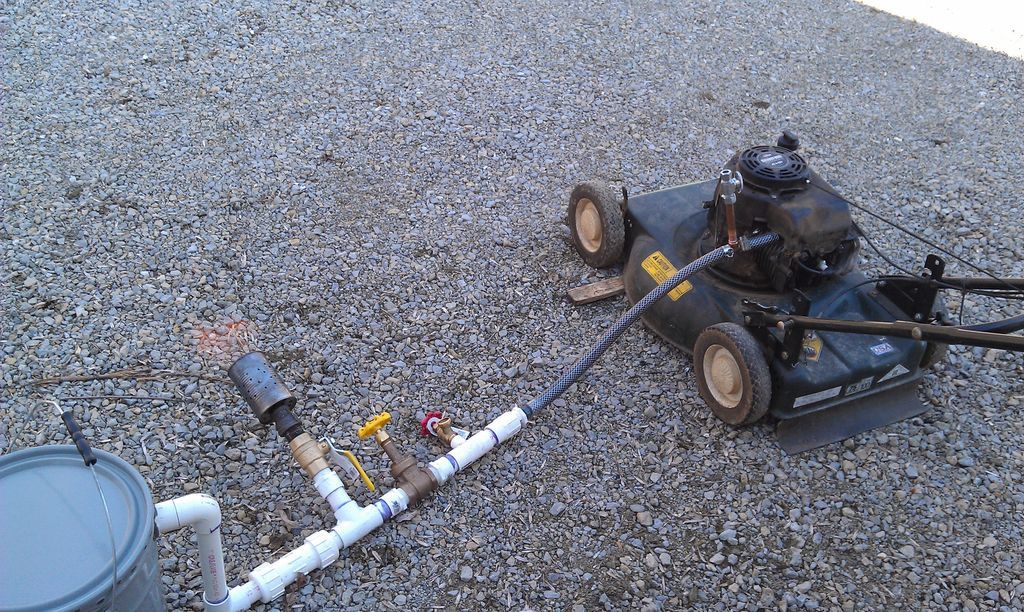

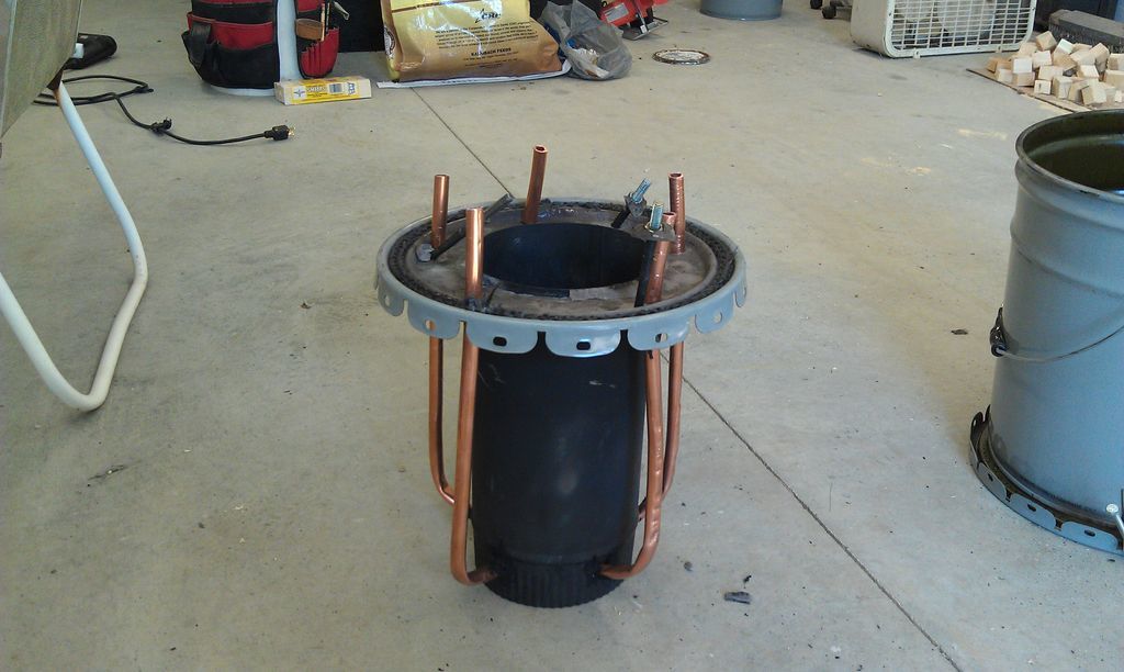

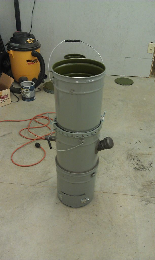

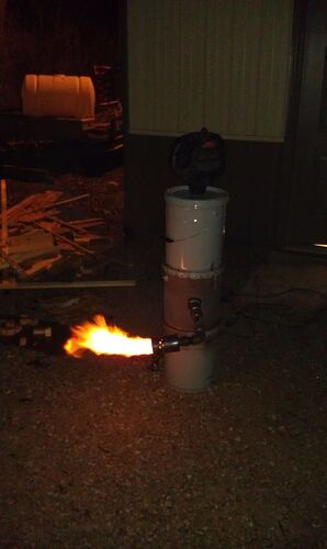

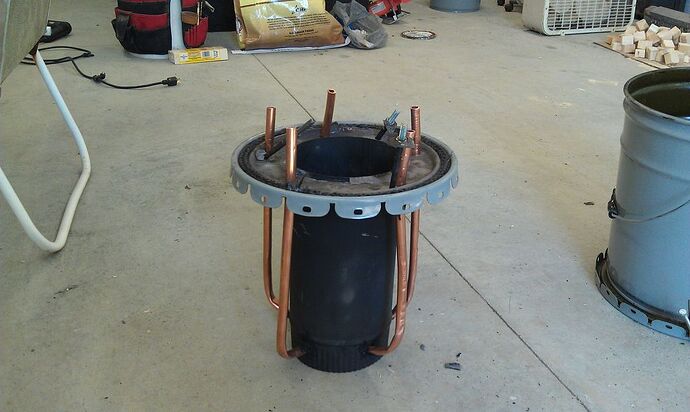

Hi Jeff. I started out experimenting with wood gas last fall and my first project was to build a small gasifier out of some steel paint cans. To prove to myself that this works I hooked it up to my little pushmower and, to my delight, it ran. It was a lot of fun showing friends and family I can run an internal combustion engine with wood. Now just a few months later I’m well into my Wayne Keith gasifier build. You will be driving on wood very soon! Also, the lawnmower project really did not take much of my time and cost little money. Attached are a couple of pictures of that setup. It is a tar making device for sure and I used pellets for wood stoves as fuel. Despite the tar it did prove to me with my own eyes that wood gas is a potent fuel and gave me the confidence I needed to move forward to a bigger project. Best regards.
I am impressed JohnC that you went to the additional work to put in air nozzles.
Good picture set. Hey All note the flare in the #5 picture.
See JeffD, most of us have one or two lawnmower engines in our beginnings. Mine was two old Tecumseh on a DYI cast iron charcoal pot and a charcoal fueled double walled pipe Tee set up. Ha! Ha! Where I learned HOT, HOT char gas needs to be de-ashed and cooled! Better to kill a cheap throw-a-way before committing to a good engine set-up.
First get an IC engine fueled and running on anything - smoke, tar, so-so high CO2 gas. And then let the IC engine needs drive you forward.
Hello West Coast Steve. The copper air nozzles were not part of the very first effort. Originally I just had a downdraft design based on the FEMA unit. I had a major problem with fire creeping higher and higher into my fuel hopper until the whole thing was ablaze. So I added the copper tubing/nozzles to gain control. Once installed I now am able to fill up the fire tube (6" flue pipe) with wood pellets and cap it with a lid from a paint can (which incidentally fits perfectly). The copper tubes come up in the the top chamber of the unit. This chamber has a lid with a hole in it where my shop vac hose is inserted. The shop vac hose is reversed so it is blowing and the vac is plugged in to a router speed controller so I can adjust the speed precicely. As mentioned, this is a tar making machine. I know I am not getting nearly hot enough to crack tar because the copper tubing/nozzles have not melted. I can run this pushmower engine at full throttle for about 45 minutes on one coffee can full of wood pellets. Certainly was a fun and easy way to learn about wood gas!
