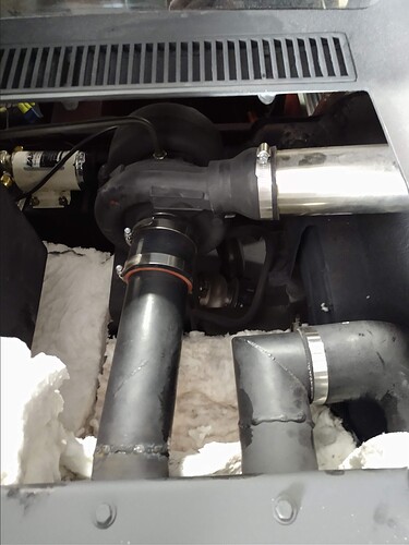

The Corvette on monster garage was planned to be rear mounted turbocharged but in the complete opposite sense of how it should work. Pressurizing the Woodgas only. So It was disabled to save our ass. Now if the air/fuel ratio was mixed before the inlet of the turbo then pressurized, I’m confident that’ll work. Eventually I’ll get to proving it with a front/manifold type setup of course.

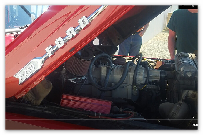

Hello Alex,
Ron Lemler took his Ford pickup with a straight 6 300 cu. in. to our Argos meetup and showed off his super charger.
I don’t remember how much boost he was getting and he was still playing with adjustments etc. but I remember him saying that it did not work like he thought it would.

Pressurising the woodgas with a turbocharger?? That sounds crazy! so did the woodgas pass through the cooling rack and then into the turbo?
Sounds like that would be an awesome project, do you have a link to the monster garage project?

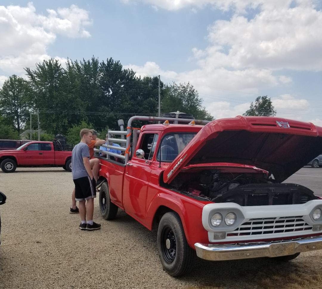

Hello Don,
Wow thats a gorgeous truck!

Hello Alex, Wayne is right in theory boosting the intake pressure will work to increase power, but I have found out it is not that simple.
[email protected]
Vesa has turbocharged woodgas successfully,he also had a book with quite a lot of detailed instructions and gasifier plans, very good reading and instructions !!
My attempt was not so great, my truck has an inline 6cyl 300 cid pretty heavy truck 3/4 ton, I was already getting 55-65 mph with woodgas, without a blower and was just curious if it could be made to run 75mph so I added a Buick M60 supercharger, and got 5lbs boost, resized the gasifier 25%.
Now on gasoline this truck will fly!! On woodgas not so good about 45mph, so I exchanged the 1 5/8 in pully with a 3in one and now am getting 55-60 mph so the woodgas was too weak ,and am considering going back to the naturally asperated setup.( like Wayne said, much simpler and still works well)
I am sure it will work, but havent figured it out , I hope this helps if you do go with boosting the woodgas I would like to see it working. :slightly_smiling_face:
Hi Ron,
Thank you for the link. You have such a beautiful truck!
It sounds already like you’ve tinkered a lot with forced induction. I was planning to go down this very same route so you’ve saved me a lot of time and frustration trying all this again.
