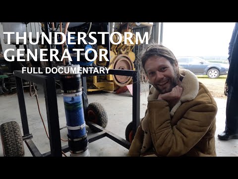

Anyone know anything about this? I usually don’t take these seriously, but this seem different; https://www.youtube.com/watch?v=m-h4N94V5s0

It wasn’t free energy. I think he was doing the balancing like the Matt said, and possibly adding water to the cylinder with the bubbler or hho with the generator. I couldn’t handle watching the whole thing. He lost me when he said something like “it oscillates but at 0 there is no frequency, and that is what makes this work”
Frequency is the wavelength over time. For any single point on a wavelength. there is no frequency because there is no time.

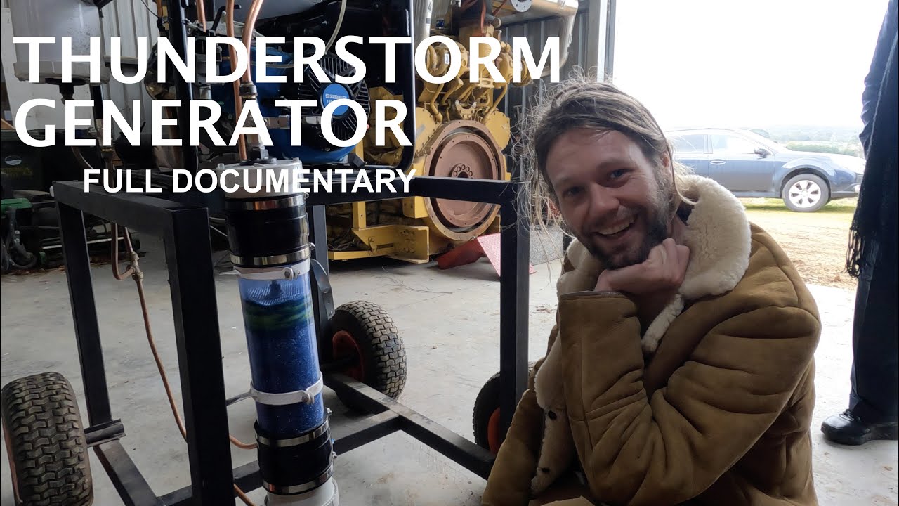

Another video surfaced it was emailed to me. This one is in english. Yeah its not a vaporator like I thought. Does he have something here? I have no idea. This needs to be in a lab with a control unit to really show me anything.
I think I know what is going on here. His apparatus is a lot more complicated than it needs to be. But basically he’s condensing water vapor from the exhaust and reintroducing it at the intake. If he does it exactly right this will increase power and efficiency by ~20%, in an unmodified engine.
If he were to increase the compression ratio he might achieve ~50 a increase. Pat Goodman modified a Ford Fiesta back in the 1970s.
This was also something the P-51 Mustang fighter airplane could do as a desperation, last ditch attempt to outrun an enemy. It’s well known natural phenomenon.

It looks like he might have a watershift reaction, from the exhaust heat, water plus the carbon monoxide. And the fact stainless steel has nickel in it which is a catalyst.
More interesting from google AI.
“higher temperatures and pressures generally favor the reaction rate and hydrogen production, but can also lead to side reactions.”
"industrial applications often use a two-stage process with a high-temperature shift followed by a low-temperature shift to maximize hydrogen production. "
Then thermal decomposition of carbon dioxide temperature range is typically 650-700C (1200-1300F)… Exhaust temperature are in the 1300F ballpark.
I did not look up catalysts for the decomposition of CO2 reaction.

If its using waste heat to create a reaction, its not free energy its a device thats making the engine more efficient. No different than Turbo its using waste energy to drive itsefl.
i honestly dont think it worked at all. It has just enough principles to make it seem plausible but the vacuum he mentions is going to be wrong. And if it was a heat thing, the exhaust tube outside would be insulated. You have the unburnt gas and CO coming off the engine that is getting recirculated, and there is potentially some hydrocarbon cracking going on. But it isn’t free energy. More efficient probably but most of the improvements are already done in modern engine designs to reduce emissions.
