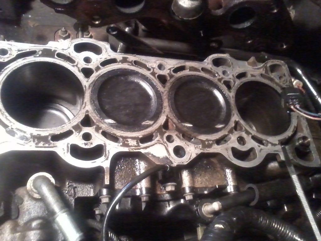

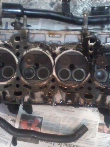

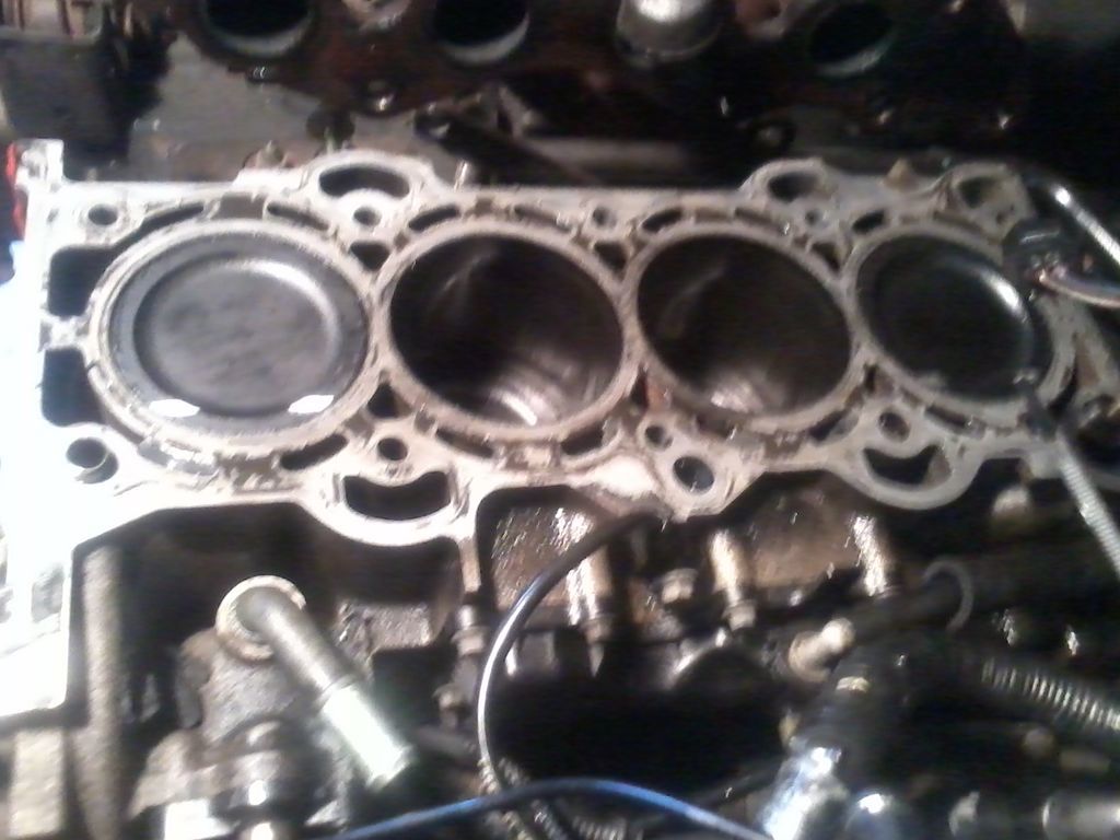

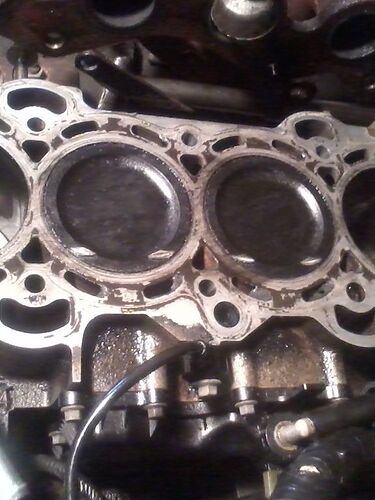

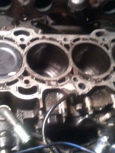

Pics. as promised I must say that with the several thousand miles on woodgas and as many times we tarred this engine experimenting with different things this engine was quite clean. No build up of any kind can be found on the intake or exhaust sides of the engine. All I did was wipe off excess black oil before pics. were shot. You can see in the pics. where the intake valves touched all four pistons. This was due to slack in the timing chain that caused the chain to jump and knock the engine out of time.

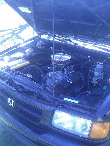

Matt that’s a nice Honda you have there what size engine did you go with?

Yeah this was the same as Woody’s situation with the ex stream cost in rebuilding or replacing the stock engine. I had an old 350 laying around with 700r4 trans. So I choose to shoe horn it in there. I did a 93 Toyota years back and shoved a 283 in it. That actually got 6 mpgs better than the stock 4 banger and it had plenty of power. I could bake the tires of in third gear. The Honda on the other hand went the other way and lost about 4 mpgs. But it was fun, the Honda I had to fab my own kit to make it work.
