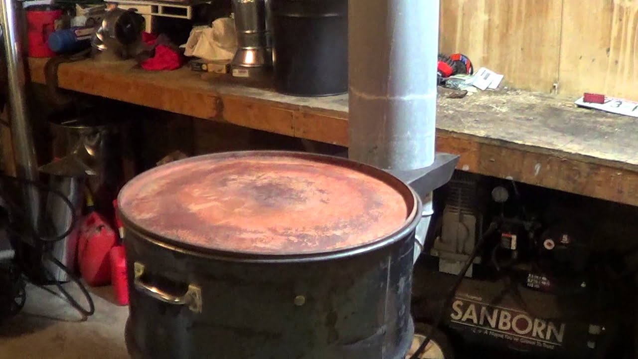

This is probably my favourite example, but they muted the soundtrack probably because they used like hendrix as background music:
I like this guys too, but it is a small retort, and I like it because someone else -really- pimped out the 55 gallon barrel design into cookstation for grilling, boiling water, etc. plus it is a shop heater.
