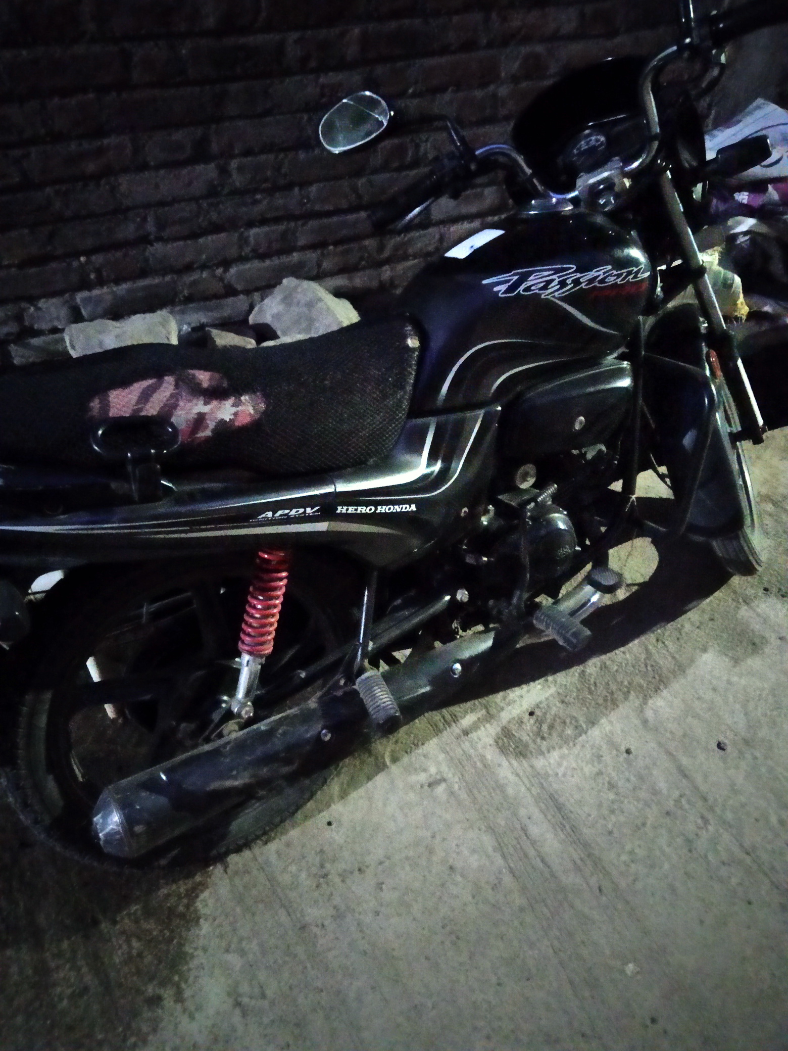

Being newby in world of wood gas I think to start with Gary’s simple fire gasifier for my 100 cc bike
I hope koen and Gary will guide me for same.just two questions nozzle size for 100 cc engine and filtration system as I read the koen posting but not understand the filter system used in pvc

Nozzle size about 12 to 14 mm (1/2")
Charcoal , well cooked, smokeless, size mixed between 3 and 15mm ( 1/8"to 1/2") dust free
Filter: small cell foam air filter or easy breathing motorcycle filter ( dirtbike type )
As little possible restriction
Change the carburator size to 26 mm, instead of the original 12/14 mm
Best wishes and succes

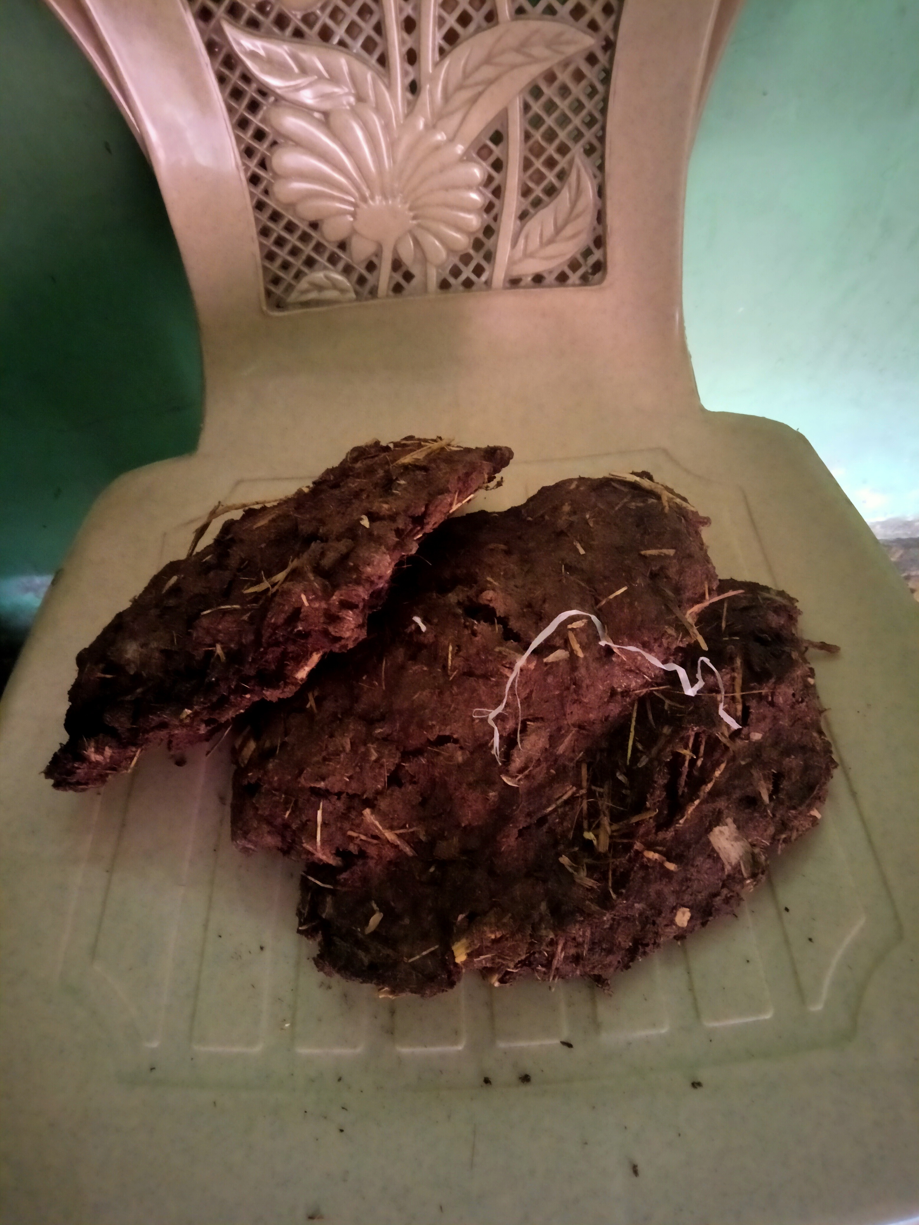

People used here dry dung for food preparation and heating purpose ,
I think this dry dung I used with charcoal in 10 :90 ratio along with charcoal and find the right proportion by trial and errors.
This is an important project. I am praying for your success. I would first turn dung into charcoal, then make charcoal briquettes with raw dung and water as a binder. There are several ways to pyrolyze dung into charcoal. I would stack the dung in a TLUD drum/barrel with a consistent pattern. The object is to give consistent airflow to allow the pyrolytic front to progress evenly downward. Use a variable speed fan/blower (hair dryer with a dimmer switch) to supply air to the bottom of the TLUD to get a good clean burn. Use some type of grate to allow the air to spread across the bottom of the dung load and rise evenly up through the whole load.

I read in research paper somewhere,the pyrolysis of dry cattle dung Which have very poor bonding and more ash content but thanks for your suggestion. A inspiration worth try.

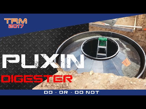

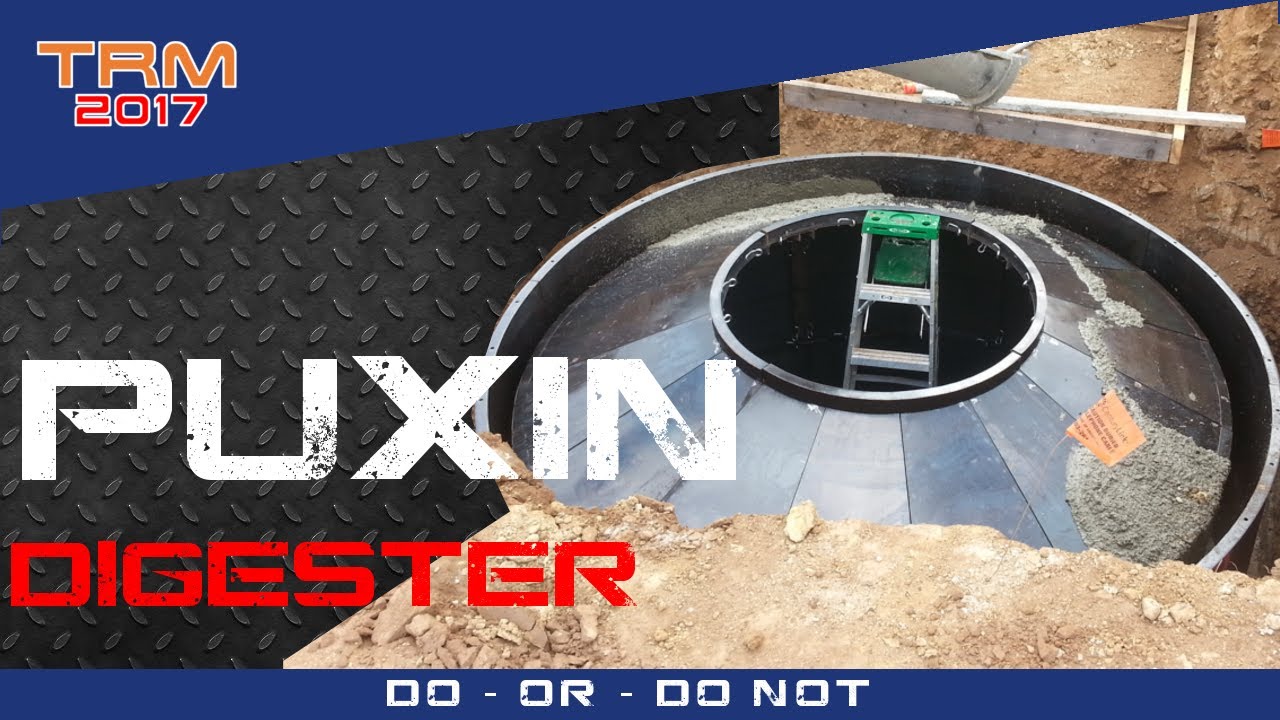

A video from the Real Martian. I started looking at these because of his aquaponic set up. a couple of years ago a big snowstorm collapsed the huge hoop house he had all his stuff set up in so I quite watching. This is his methane digester. You need a lot of crap to make this work. Pig farm. Dairy farm. Thinking you are going to make much gas in a bag with kitchen scraps in a fool errand.

Maybe a peterson press with a 2 - 4 ton hydraulic jack. If your cow dung is very dry and powdery then a starch binder works very good.

Peterson press works good with hydraulic or scissor jack. No need for starch. Dung is the binder of choice on mud houses for millions.
