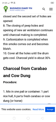

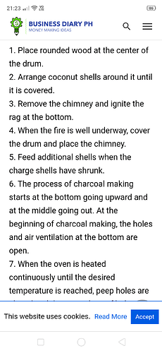

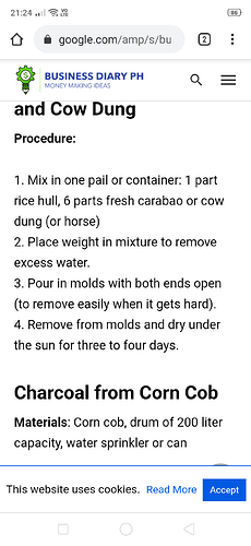

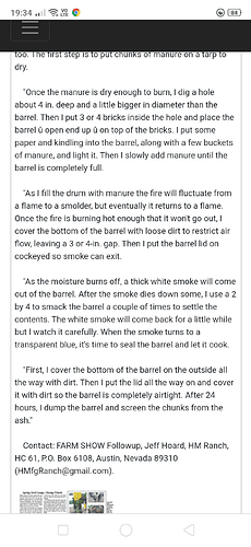

I also seen much videos on YouTube the dry dung with mere moisture 20% work on press and briquettes are formed.but my opinion those to be charred then briquettes to be made made of size mentioned in simple fire gasifier.
And agree with Mr.bsoutherland

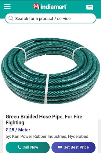

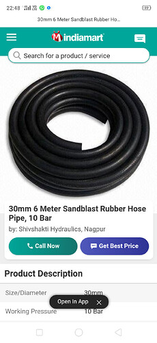

eBay link above is not opening, I have searched in local market and got hose pipe but of 1.5 inch id, and sand blasting pipe on local online store indiamart. Will work there’s is also pvc hose of 1inch size Will it work?
Vinod , don’t buy that ! well fir sure not the pvc hose anyway the rubber hose would manage lots better , but can you not get any Ebay in your country ? what about Aliexpress ?
the link i sent you before was just showing Australia , as that is where i am but if you put in the words "stainless steel truck heater pipe " into your ebay it should come up with something , if not you could make the rubber hose work fine .
