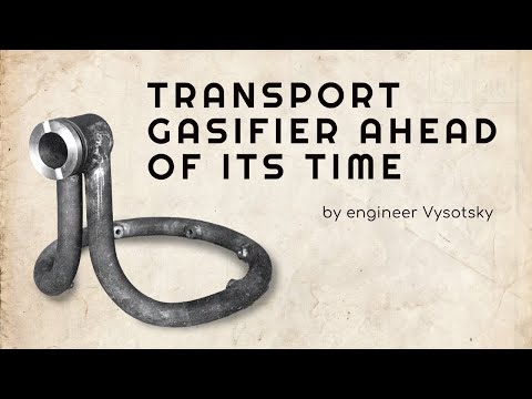

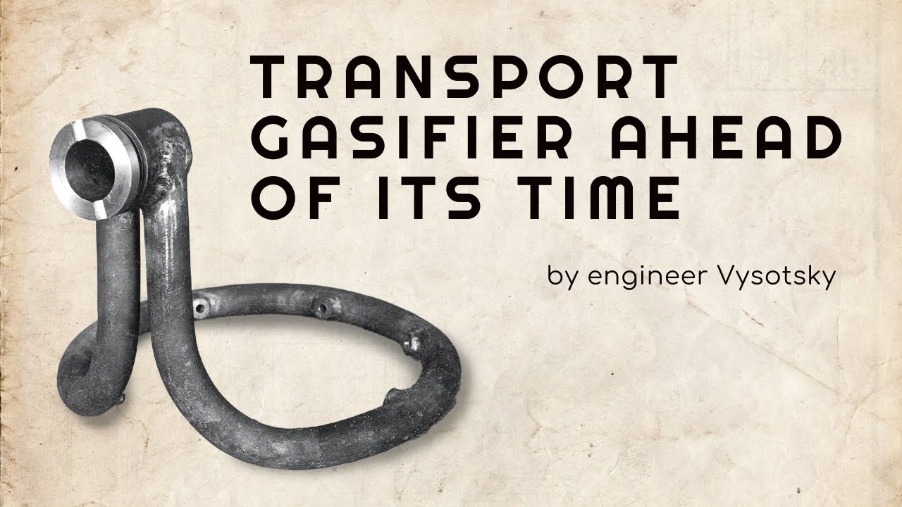

Here is something I have not seen before.
The patient that used oxigen too feed gasifier, would cost more too operate than gasoline, likeley.?
Yes definitely. It might have used an on board oxygen pump but that’s still one more thing you have to maintain.
