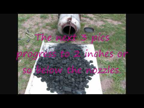

I stand with Tom Collins on store bought charcoal. Briquets are practically useless for anything except to burn hotdogs. Watch my video on fuel analysis.
I threw in some leftover briquets as a test and they seem to go through the system practically unchanged! Huh! was my first reaction. Brickettes, I say! That Texas made real wood stuff is a little better, but sold by weight it is not fully pyrolized thus keeping it “heavier” along with the price. Also some initial heat from the burn will be used up (wasted) finishing the pyrolysis process and possibly introducing some tar effects to the system. I never followed up with Part 2.

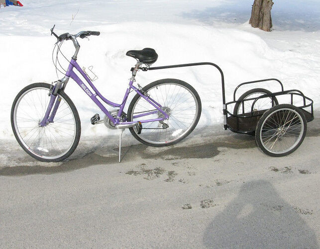

Anne,
This is what I would do if I already had a small engine like you do to play with. I would build a Gilmore Simple Fire charcoal gasifier on a bike trailer with the engine on a centrifugal clutch with just a throttle cable running to the bike for control. This would be an easy setup to get you started with minor modifications to the bike. To keep it really simple and get you going quick you could use a rub wheel on the engine shaft as friction drive to the trailer wheel.
