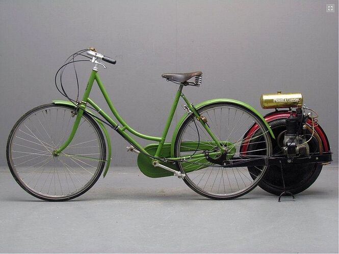

Last night I was thinking about way to mount a gasifier and the vintage Monet & Goyon motorwheel came to mind.
http://www.yesterdays.nl/monet-goyon-1920-motorwheel-p-2565.html
Perhaps great minds are thinking alike and all that Don. I agree though that there are some advantages in making and using a push trailer. Being able to change the trailer over to another bicycle or tricycle would certainly be one of them :slight_smile:

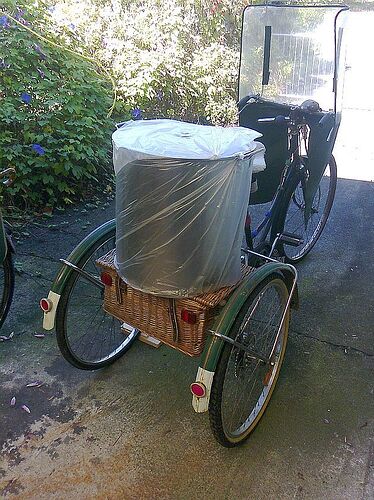

Hi Andrew, I must agree with you about the single wheel trailer idea. At the moment I’m doing some work on my tricycle and I’m starting to seriously think about putting my first attempt at a charcoal gasifier on my tricycle instead of a bicycle, My tricycle has a lot more room for all the plumbing and it’s a more stable vehicle than a bicycle.

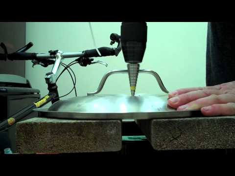

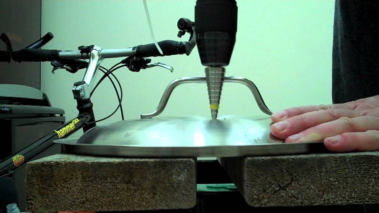

After having problems with trying to track down a 5 gallon steel bucket with a lid due to such things having been entirely replaced by plastic here in New Zealand, I decided to go with the stainless steel stock pot idea. An on-line retailer here has been selling large stock pots at a reduced price and I was able to get a 70 litre stainless steel stockpot with lid for just $NZ30.00. So I can put my smaller s/s soup pot back in the cupboard where it will no longer be endangered by being taken into my workshop.
I found this tutorial on drilling stainless pots that I certainly will be putting into practice.
I also checked out the link and it worked fine for me.
The 70 litre s/s stockpot arrived this morning and all I can say is that I’m glad I’m not a chef who has to heave one of these things around when it’s hot and full. :cold_sweat:
At $NZ30.00 delivered it was to my mind a better option than trying to track down a hard to find mild steel 5 gallon bucket that would only rust out in the end anyway.
