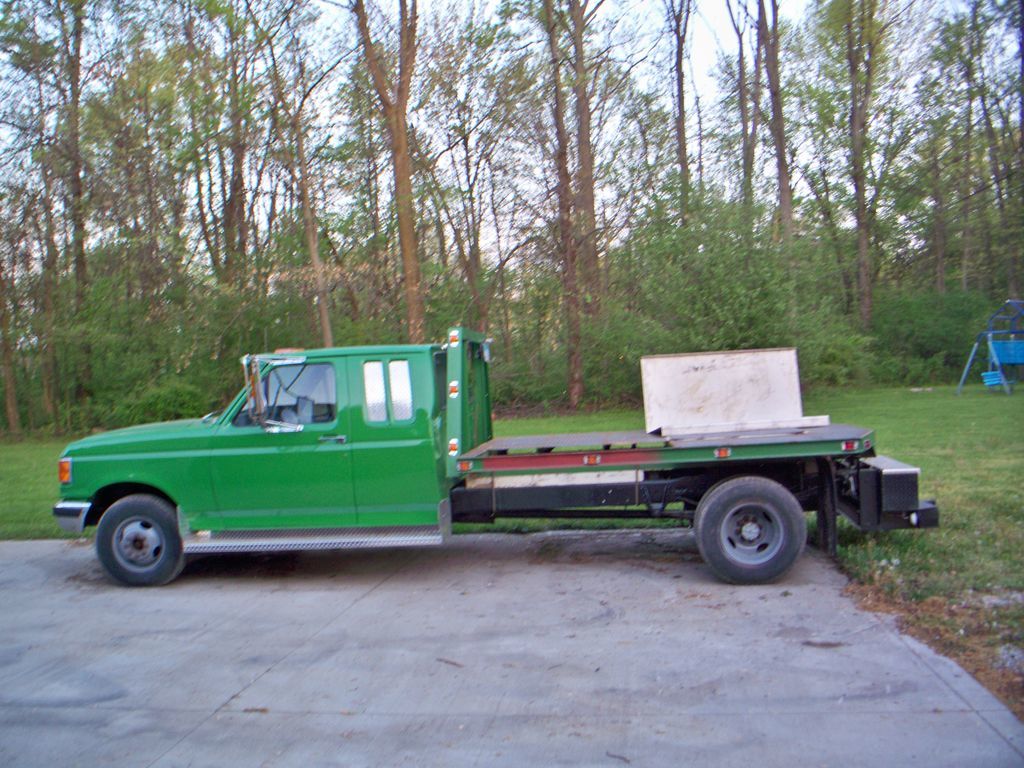

I am planning on mounting my, Wayne Keith gasifier in an old European style lay out, what do all you gasser think, is this the way for me to go?
Hi Dave,
You forgot your cooling rails. How were you going to cool the gas? Also the ones towards the back look pretty lonesome… but more importantly they’re unstable with nothing to tie to. Might consider the standard layout. Tried and true…
Will you be able to fill wood and poke down standing on the ground? If not, you will have to leave walking space from the back. Will this be a work truck or play truck? Is there a reason (fuel tank or something?) you put it on the traffic (splashing road salt) side? I seem to remember European pics with it on the ditch side. Maybe UK right side drive? Looks good otherwise!
