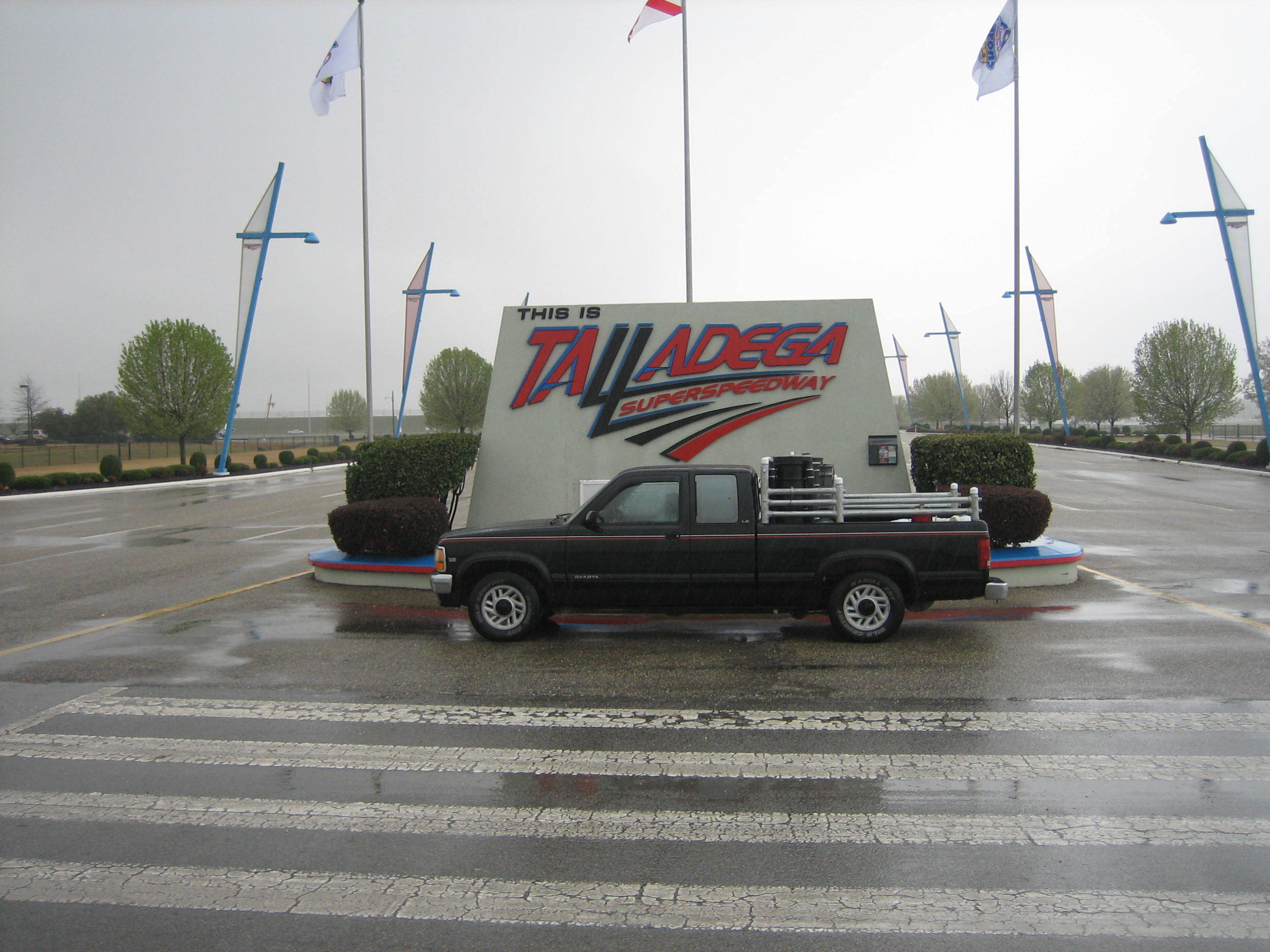

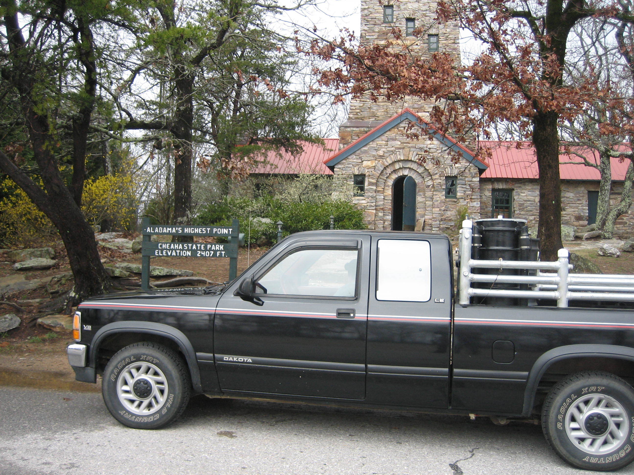

Good morning Billy,
Load up any time and come on over the hill. ( Cheaha )
For those not familiar with the hill it is just a few miles southeast of the Talladega race track and a real good test for a gasifier climbing it .
Mike LaRosa says we have no hills in Alabama ![]()
