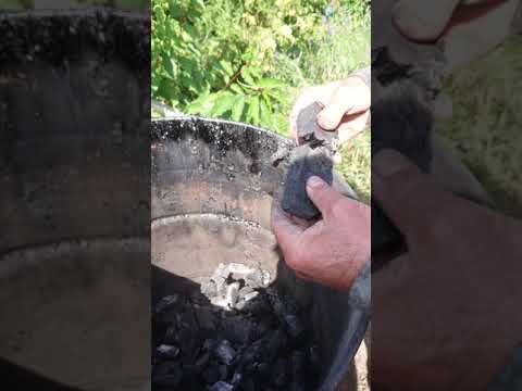

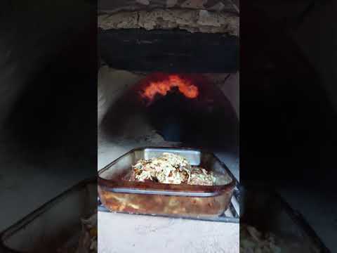

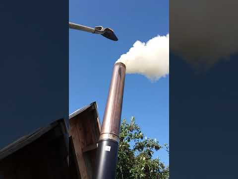

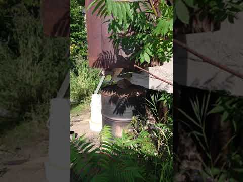

here are some videos as promised
first: baking, pizza, quiche, bread, cake …
second: dismantling the oven
third: evacuation of water vapor
fourth: tests coal
