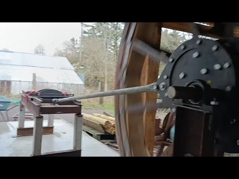

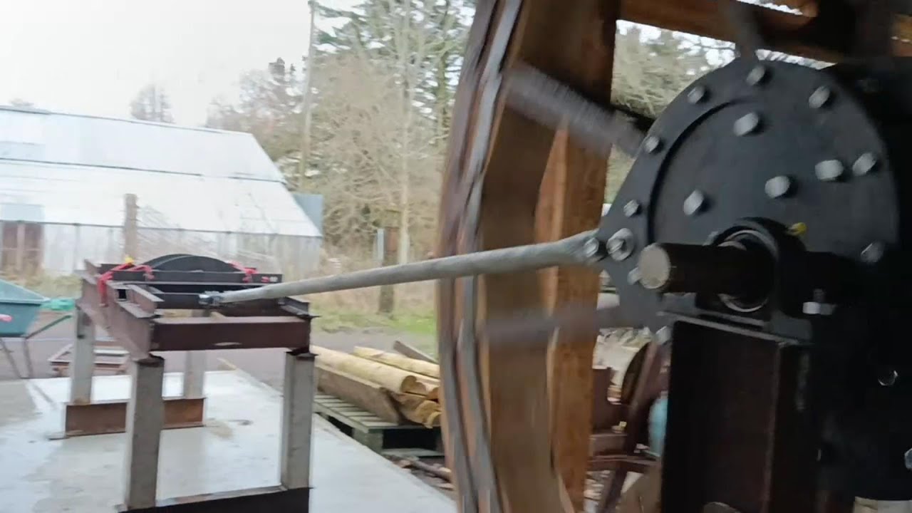

I think I’ve processed more charcoal with my hand cranked grinder in an hour than this unit could in a day.
Wow.
I am hoping to finally get my charcoal grinder completed soon and I really hope it will be more efficient than this thing.
And they say the Germans over engineer !  well this is one up for the English anyway .
I don’t know the reason why they are trying to grind the charcoal smaller , my guess its  for Bio char  , this will work if they were to open the gap between the  blade and table and also another gap for the backward  stroke  and most importantly on mine was to use DRY charcoal , wet charcoal slowed my crusher up real bad .
OK.  Is it going to kill people to take a grinder and wire wheel and clean up some of the stuff they build with.  Makes me cringe.   That grinder was certainly stupid but the links after were good.  Ford Model T snowmobile Dust off Ride 2023 - YouTube
I’d like to belong to that club.   I’m with Cody.  My char grinder isn’t much but it will do a five gallon bucket in  a short time and it’s hand cranked.  Similar to Chuck Whitlock’s grinder only his is much nicer.  Making charcoal fuel is just not that difficult or complicated.
