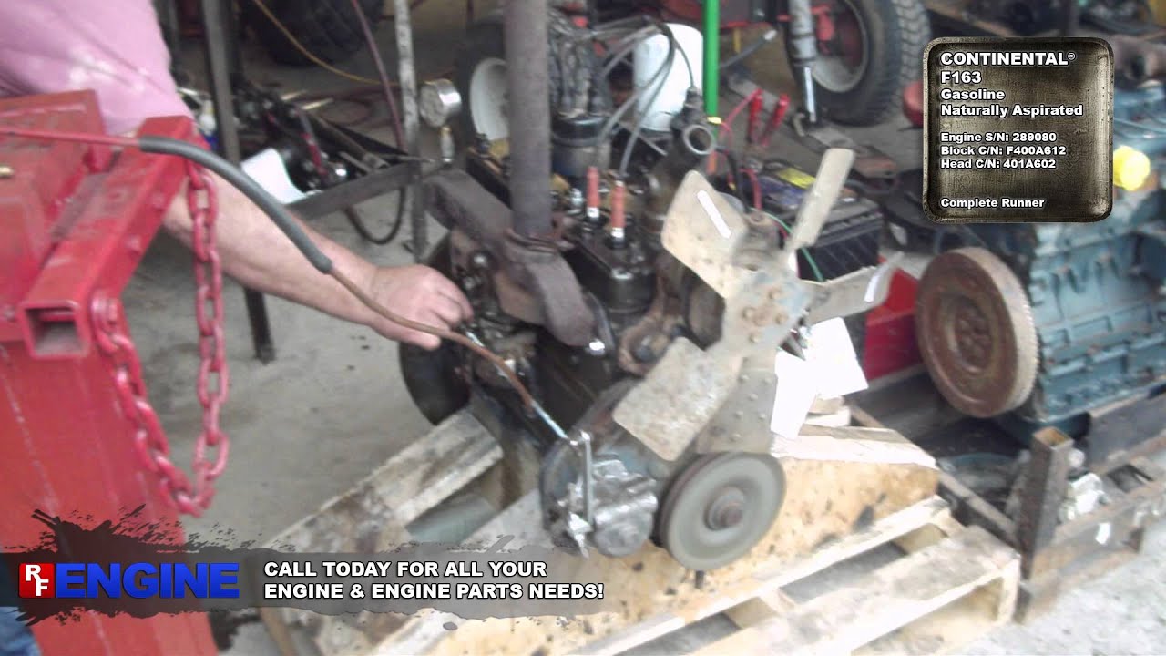

Continental made some good industrial engines you find in forklifts, jeeps and welders…
I have one…
In this video you see nice little continental for sale.
Next to it you see a Kubota ( d1150 I bet ).
I bet you this guy pulled the conny to install the Kub in a SA200 welder to save fuel.
This is pretty common conversion.
For a guy that wants a Chip systems I would look real hard at the Conny F 163 because there are plenty of parts for it and they are are readily available as well as easier to work on that the little Ford.
I do like that Ford I just don’t think its as good as an industrial engine.
