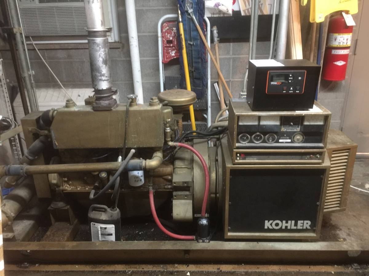

Well, this is a 45kW genset and I’m guessing (haven’t spoken with the owner yet) that it’s a four cylinder engine though it could be a small inline six cylinder but, I doubt it. I figure that it would take a beefy four cylinder to turn a 45kW generator. As I mentioned it’s currently set up to run natural gas. Thanks for responding.
Interesting.
That looks like it has a water cooled exhaust maybe this was a marine set?
Now this is much different than mine because of the size but it still a very good set.
You need to find out what brand of engine it has just to be sure you can get parts for it long term.
And your not going to want to spend big bucks on it because as your first wood gas project you might end up getting tar in it and sticking the valves or rings.
How about something smaller to start, unless this is free or near free I think its better to start smaller and work your way up.
A unit this size is also going to burn a lot more fuel than you might expect.
I am thinking that might be something like an inline 6 maybe a ford 300 inline.
That’s a lot of fuel!!!
This is part of a project to take care of the entire homestead. I have access to a smaller generator to play with until I get the hang of clean gas. I don’t know if it’s treasonous to mention a different gasifier but, I’m building two of these Peterson designed gasifiers. When I was looking for a good design Peterson’s name kept coming up and after I dug into his design it looked like a winner. He warns that this particular design is difficult to make workable with smaller one and two cylinder engines but perfect for large two (or more) cylinder engines.
He does some Youtube videos with what looks like large V twins turning the generator and says that you can expect to get anywhere from four to eight hour runtimes depending on the engine size. More if you attach an added feed hopper.
I figure with two gasifiers plumbed into a single supply line I can keep the generator running long enough to charge a battery bank and run everything that will put a serious load on the generator each day (well, machine shop, welder etc). Not everything will need to run on a daily basis but it’s nice to have the ability if needed.
I don’t know if it matters but the owners manual that comes with the genset is Kohler. I’ll be certain to ask the owner about the engine make but, couldn’t this be a Kohler engine? I noticed the stack coming through what appears to be a water jacket and it never occurred to me that it could be a marine engine.
I’ve owned two vehicles with Ford inline 300 engines and, to be honest, this engine looks to me to be about 2/3rds the size of a 300. But, I could be wrong. The engine on the genset looks to be even smaller than a 250 C.I. Ford engine in an old Falcon I owned and it was rated at around 155 HP. It will interesting to see what is powering it.
One of the things I liked about the Peterson design is a programmable throttle control you can add on that helps marry the gasifier to an engine where the power demands really swing up and down.
What about the conversion from natural gas to wood gas? What’s involved going from natural to wood gas? I realize that I’ll be giving up some power but if I can maintain 75% of the rated output of the generator I’ll still be in tall cotton for everything I need.
Any threads you can recommend to spare your time would be appreciated. I hate asking questions that have already been answered or worse, I’m the 100th guy you’ve answered the same question for. I do appreciate your help and advice!

I’ve had my eye on this unit for some time. I was hoping someone would
show us the ins and outs.
Pepe
That will be hard to do.
Expect 50% or less.
The heating value of the gas is low and the engine will also loose power drawing on the gasifier.
The guys with more experience in this is ( like Matt he builds turn keys systems ) they will tell you what to expect.
Turn down ratio the difference between full load gas production and the minimum amount of gas the system can produce that still tar free.
Can’t help you there, but I understand your problem…
Kohler made water cooled 4 cylinder engines. (L600 - L645 http://www.oldengine.org/members/diesel/kohler/Kohler51.htm )
But they were old flat heads rated at less than half of what you got there.
The gold paint and style of writing on the decal leads me to think this is newer than 65 ( not blue ) and possibly as new as the 80s ( style of print )
Might be a GM engine…
Something rated in the 90-110 Hp range probably a small six.

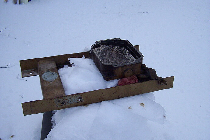

Machinist want me to bring him in the kohler block and crank so he can take more measurements.
SO I stripped it all down in the cold.
found about 1/2 pint worth of ice in the bottom of the crank case and more rust inside than I expected.,
If there ever was any doubt this engine is KA-PUT well this is it.

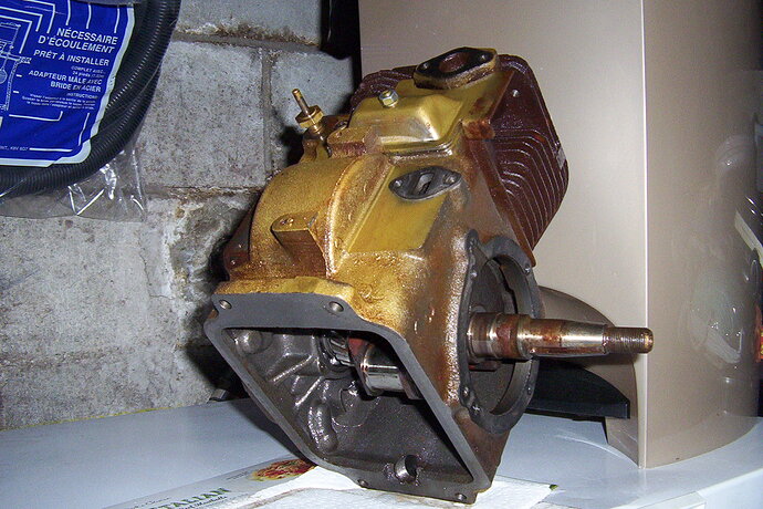

And yet I got a Sisson choke and Repco ignitions, spares for the K90EP engine I have on my other little plant.
Guess I will take a picture…
Makes it look like I am doing something productive when I post pictures.
I hope Wayne’s got a good deal on bandwidth and storage because I post a lot of pictures and he never says anything.
Tell me if this is too much photos and I will cut it back friend…

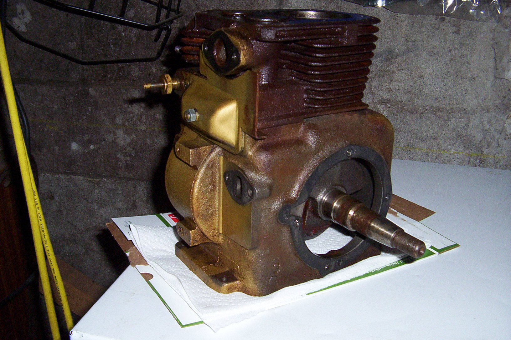

In some senses the way they used to make engines makes more sense.
All the strength and rigidity of the casting is built around the business end of it and so there is less flex in the block.
The weakest point on these is the cylinder breaking off the cranks case in race application.

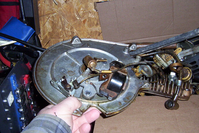

Looking at the other side you see where the stator plate ( made of cast aluminum like the base plate ) attach.
All of this makes for a more costly casting and fabrication.
But its a stronger engine, trade off…
Go back and look at the Honda now and compare.
The Honda is a great engine but its weakness is that gaping hole the side of the block.
The stress and flex in GX crank cases means they tend to loosen up the case bolts and then the crank case separates from the cylinder in race application.
Repco ignition, you don;t hear that name too often anymore I wonder if they are still in business?
No matter, the interesting thing here is the points are not under the flywheel on the K series engines so its easy to tinker with your timing on them.
