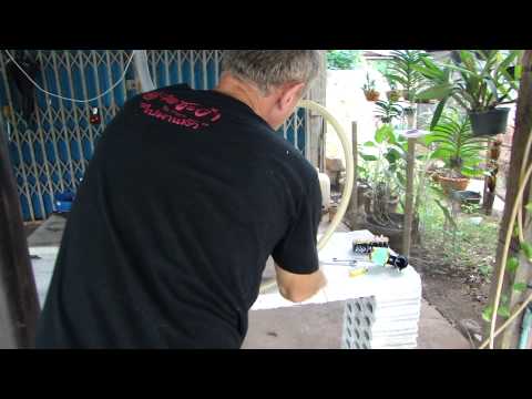

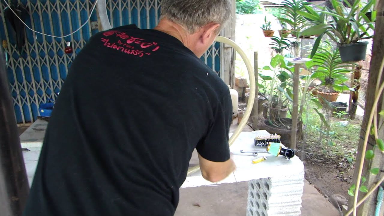

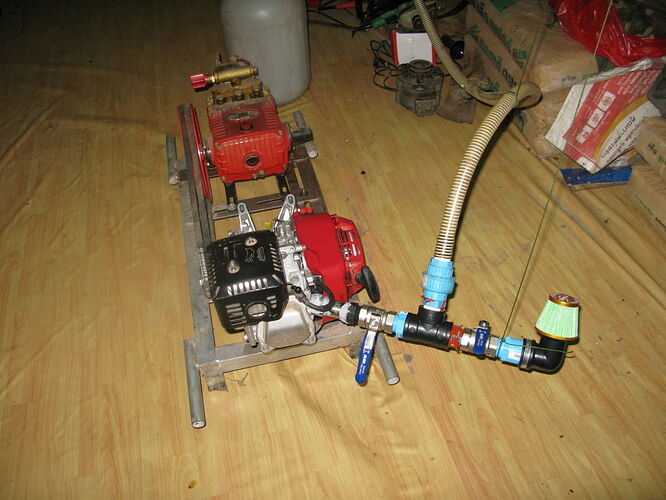

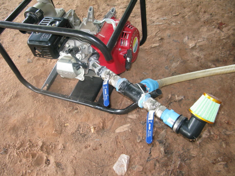

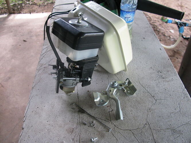

Carburator replacement for the Honda GX200, ready for testing tomorow
Modified the ball valves for smooth operation, even might consider to connect the load adjustment from the engine ( governor ) to it

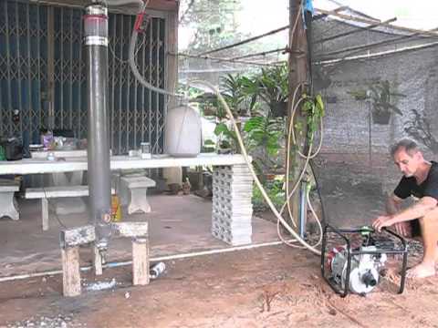

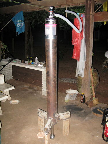

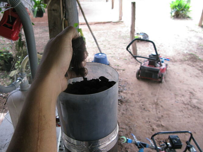

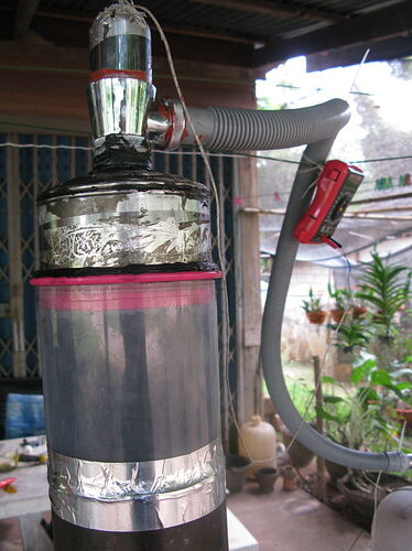

The modified gasifier, lifted it up for about 12", made easy replaceable nozzles, threaded hole in bottom for ash removal.
I gave the top a “see trough” plastic with airtight lid, just for the fun of it.
I consider to install a temp-sensor from the car, to automatic switch of the engines ignition if the temp rises to high.

KOGI 2 was tested today and performed very well… Tomorow i will upload the video’s on youtube
Today some data and some pictures

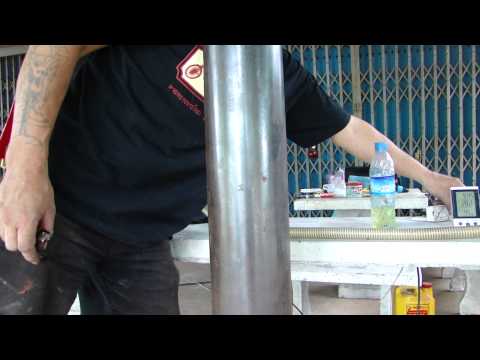

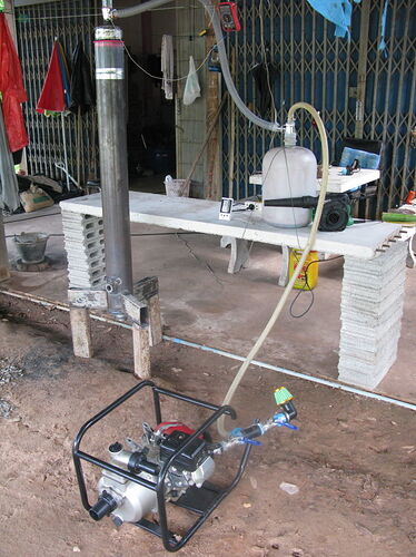

pic 1 the todays setup

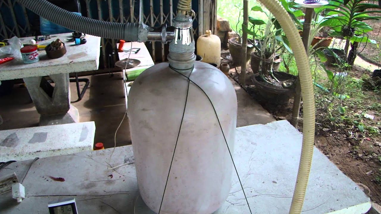

The system ran, after a first difficult startup since the modifications on the gasifier, for a hour and half.
It consumed 1,2 Kg charcoal in 90 minutes runtime

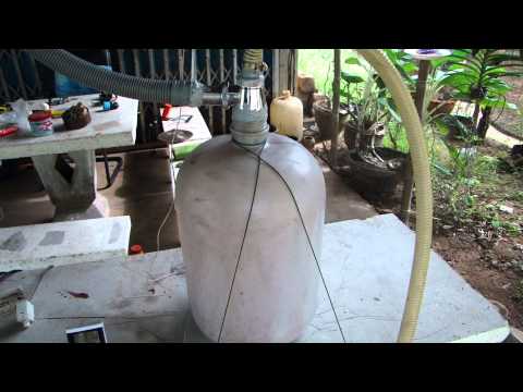

added a see trough plastic on top and a coarse particel filter, in the plastic tank on the table is bottom oil, to trap the remaining dust

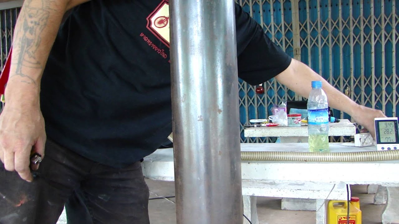

Tomorrow i will post the the clip what impressed me most,…
The reaction of the gasifier and the engine Rpm when i sprayed water on the outside of the reactor and made sure the steam vapor was sucked in the gasifier,…
I should change the project name: “How to run an engine on green waste charcoal and water”
It is amazing what effect the water gives…

Hi Koen,
I may missed something here but is there a reason for removing the original carby. If you leave it in place it will control engine speed off the governor.

The steam is getting into the air inlet of the reactor but it is not as visible on the video as i would like it
The temperature of the gas stays “steady” around 40°C, measured above the reactor in the shiny siphon.

Hi Gary H,
I stripped the carby off for a few reasons…
1: more convincing when i show this to wise guys who don’t believe in gasification ( some even think the gasifier is a gas-bottle… and the engine running on propane)
2: The elimination of the restriction in the carburator, the restriction of the venturi was from 19 to 15 mm, now i have a straight 25 mm
i think that compensates a little for the power.
I also made some modifications to the ball valves so they can be connected to the governor if i want and that will function to.

Barefoot !!! No way could I do that. Like my shoes tooooo much. Nice run on the charcoal gasifier. The water spray got enough H2O into the oxidation zone to boost the hydrogen content of the charcoal gas as should be expected. You do not have any exhaust gas return yet to temper the heat of the oxidation zone. This exhaust gas will have some water vapor in it and unless you are in a very dry climate, will supply a lot of hydrogen. In my first charcoal gasifier, I also used water, but soon found out a lot of it was not converted into hydrogen but mearly evaporated and then recondensed in the filter. Came to understand there was enough water in the air and charcoal to make into hydrogen. Any additional water was more than the gasifier could convert into hydrogen and just condensed back out.
Now that you have a system up and operating, let me make two suggestions. Increase the diameter of your charcoal generator (at least 12 inches) and get the exhaust gas hooked up to the air inlet. Of those two, the exhaust gas hook up is a higher priority.

The piping was that what i have available (5") and it works so far good. if the level charcoal goes beneath 24" (from nozzle) then temperature increases.
I switch of at 60°C
The water spraying had 2 purposes;
1 defining the “hot zone”
2 the Hydrogen effect
Since this pipe 5" is all i have momentarily, i am going to drive this to the limits. just to observe and learn.

As you could see on the video, the outside temperature was about 28°C and the humidity was nearly 80%, and still a good effect with the water.
