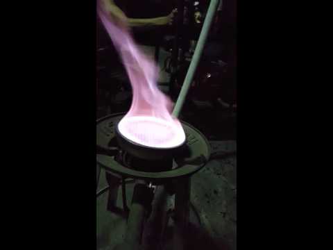

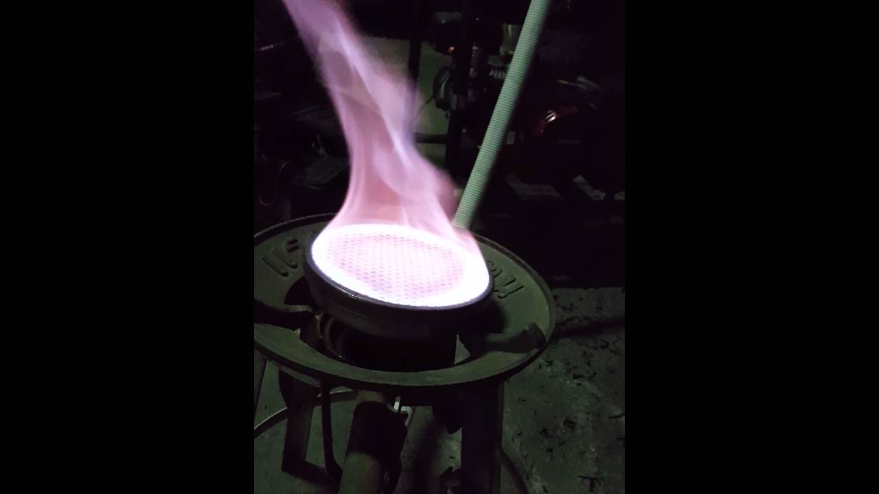

Doing some “out of the bed, boring laying on my back” gas exercises…
Using a modified ceramic cooking plate…
Making it glow…

Does it mix with air above or below the ceramic plate? If below, what kind of orfice for 50/50 mix?

I mix below the ceramic plate, even before the fan.
I added a mixing/metering valve between the filters and the blower, then feed that mixture in the Ceramic plate assembly.
In 3 video’s i only use the charcoal, in the 3 others i ad water.
I am lucky to use the fan’s without their motors in the gasstream, not sure about bilgblowers…
I am testing this setup, to be used in a ceramic factory, but i think i would need to adres the nitrogen content of the gas for reaching sufficient heat…
More fun coming up as i want to test the charcoal flame gas to feed it back into the gasifier.
