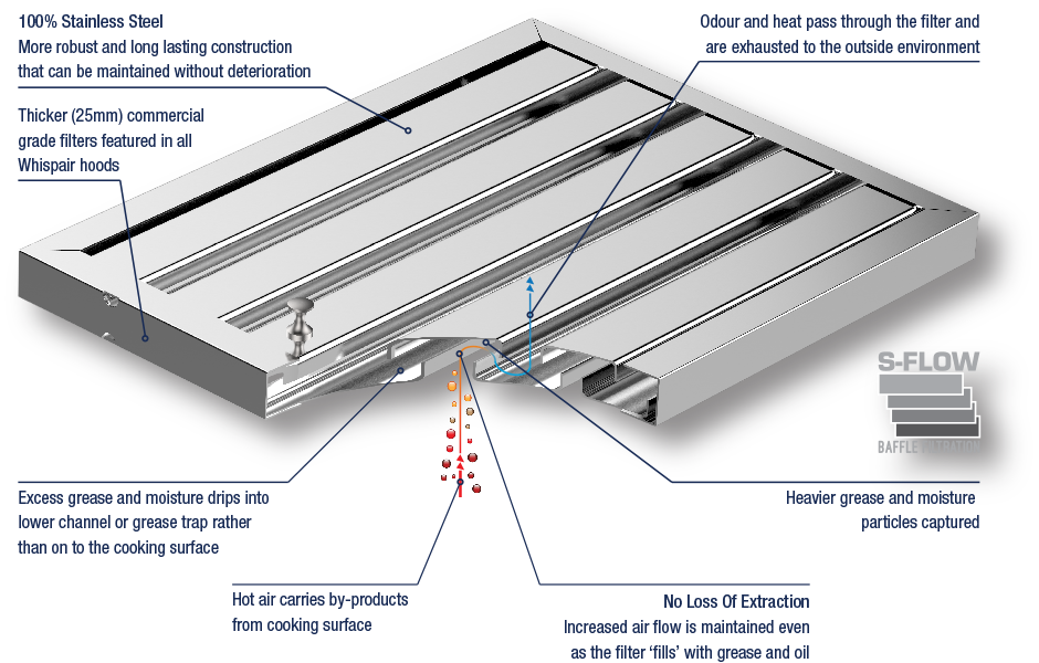

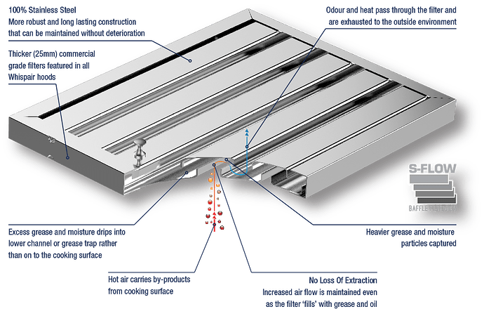

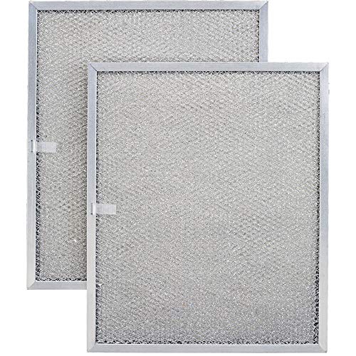

I was at Home Depot today and they had a bunch of replacement grease filters on sale for your vent hood over the stove. It got me thinking is anybody using or tried to use one in there hay filter to try and trap more ash and or tar if it got that far? They make a mesh style that might give too much back pressure. Also one that kind of works like an oil bath cleaner, more commercial style. Both are cleanable and reusable. Anybody see side affects?
My first thoughts on this is, it would lack surface area. That is why hay filters are used. There’s a whole lot of surface area to absorb moisture and charcoal dust.
I worked at a few restaurants years ago. Had to clean the exhaust vent filters like you’re showing. They will catch a fair amount of grease, but not all of it. Might work as a pre-filter to extend the life of filters that require replacing. I don’t know about tar and creosote, but lye does a good job removing fryer grease. Makes it’s own soap.
