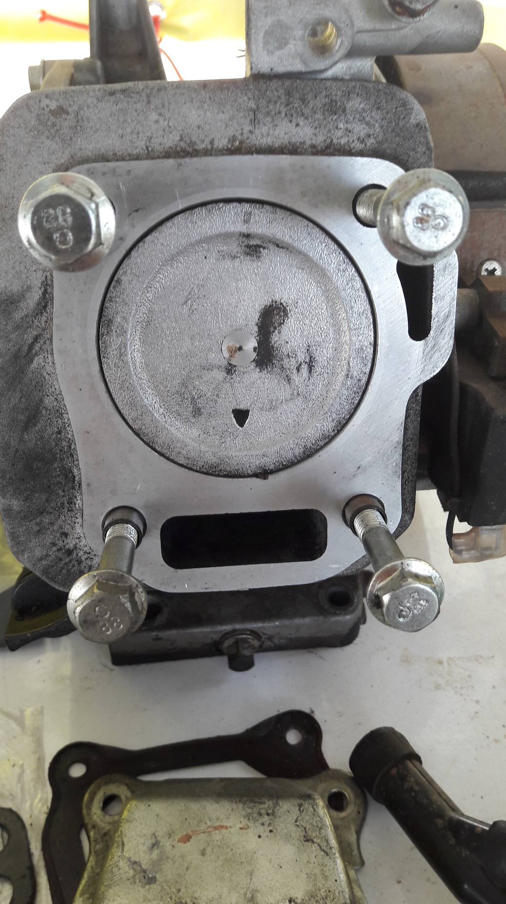

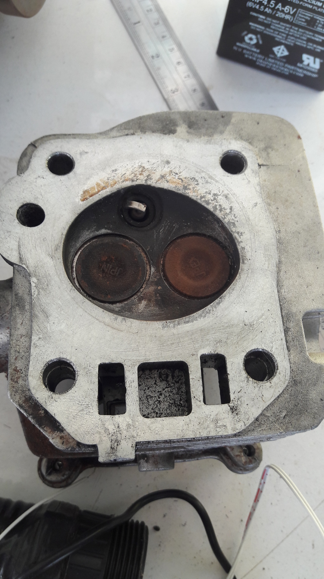

Very clean inside.
Could you take an even closer picture of the head and piston?
If you can buy a GX200 replacement cylnder head gasket that will give you a small compression increase if you plan on returning this engine to service.
How does the cylinder bore look?
I wonder how much wear you have ?
500 hours and its so clean inside!!!

Is that a small triangular hole in your piston face? If so, is it supposed to be there?
The GX200 has a very very short rod compared to the length of its stroke.
To compensate for this the wrist pin is offset slightly from the centre of the piston to reduce the amount of side force on the power stroke.
In a perfect world the Small block would have a deck about a three quarters of an inch taller, but it had to be a cube shape that fit where the flat heads were installed and the solution was this offset piston.
it is a marker, but is it pointing to ? no idea where it should pointing
Wallace’s comment above explains the piston arrow marking.
So the offset piston pin is located to the correct side of the engine on assembly.
Piston will noise slap and have accelerated side skirt wear if put in 180 degrees wrong.

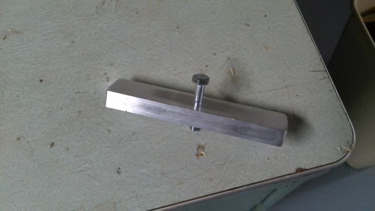

Made me a poboy’s depth gage for sanding down heads. Bolt is 1/4-20 so one turn is 0.050". Should make a pointer for the bolt.

You might want to consider set up a jig for the head to draw file it if you get uneven sanding ( one side higher than the other )

A poboy could also play with blueing and hand scrapping. Poboy is also a song. I have the best luck with primitive tools. Slow but works…
Prussian Blue, a mirror and Draw filling is my way.
Finnish with a strip off a belt sander.
But yes its slow and steady vice work.
