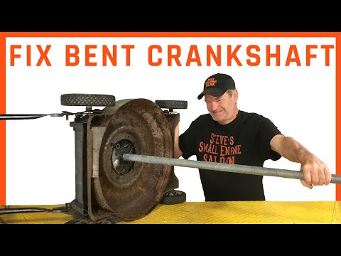

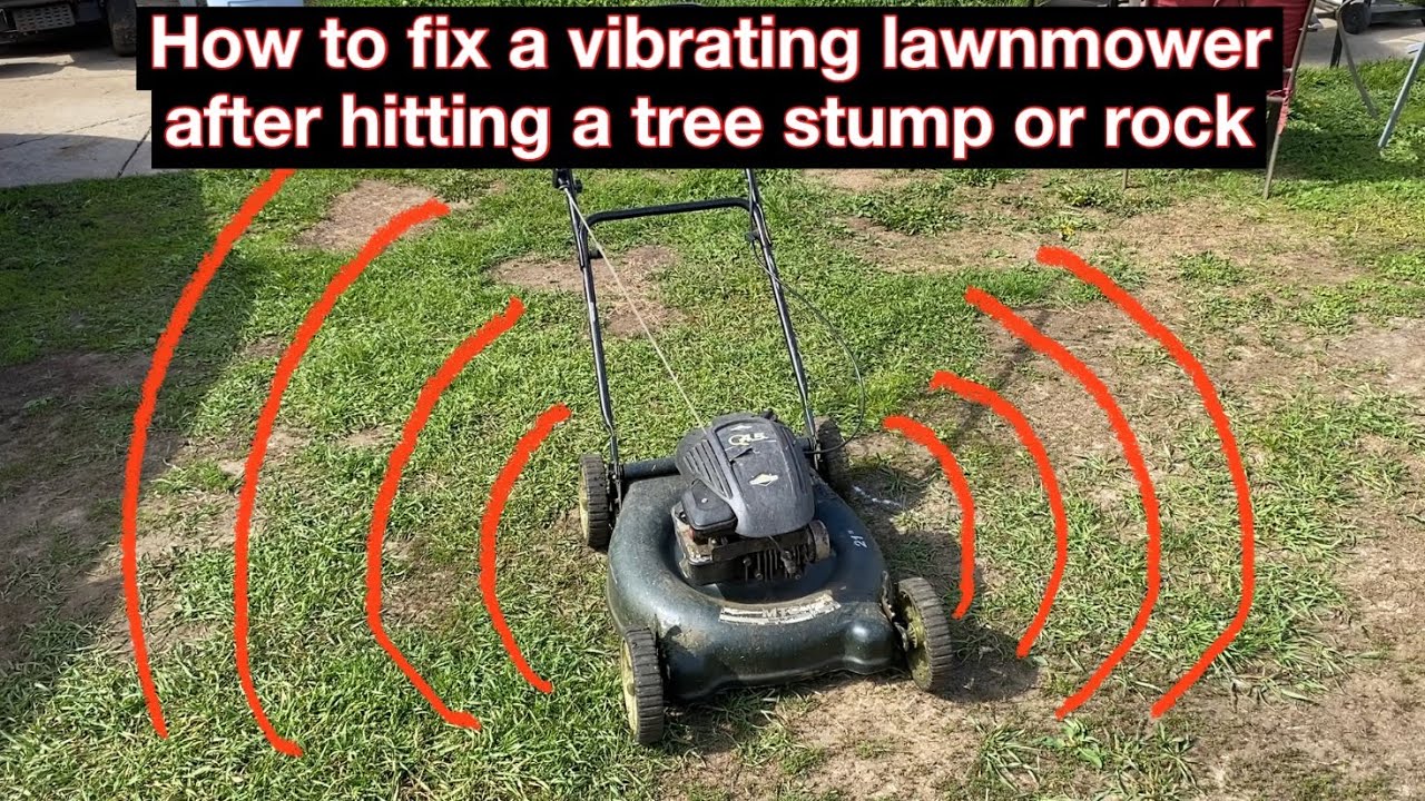

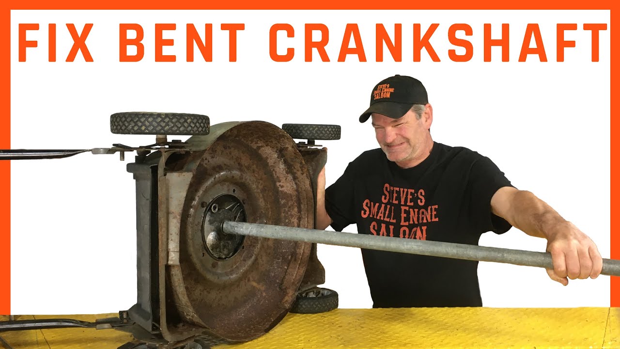

I have an old Briggs lawnmower with which I hit a marker pipe 32 years ago. Crankshaft bent and wobbeling. I did the exact same procedure as Steve - big sledgehammer. With a bit of luck it works. The mower is still running strong and almost no vibrations.
Depending on the age of the engine, like say a Flathead Briggs, they didn’t even use proper bearings. The output shaft just rides in the crankcase with an oil barrier. I’ve witnessed this on more than one Bolens engine. Has a long aluminum surface with an oil notch.
I think it is a 7hp Briggs and Stratton Engine 128602-0264-E1 and you are correct, I don’t see a main bearing just a seal. A new shaft is 4x more then I paid for the whole thing.
I have to check it, it only rubs when I pick up the mower to move it, or it is going over a dip in the lawn which could indicate the deck is flexing as well.
Here is a couple of videos on push mower bent crankshaft straightening:
This guy misses two important beginning steps. Does show marking; and the big hammer method though.
Next one showing the long pipe method WITH the two initial set-up steps:
Your choice. I’ve done both successfully. Successful until the rest of the mower was no-longer-useable.
I’ll bite. What did he (probably me, too) miss?
One for sure, didn’t take sparkplug wire off and remove spark plug FIRST THING!!
Also, did not protect shaft/ keyway from hammer blows. Maybe did not show damage caused by bad work habits. Also, did not show engine running before and after comparison. :cowboy_hat_face:
Yep. Yep.
You got it right MikeR.
Also all walk behind mowers for-sale in the the U.S. for decades now have had to have a mandatory quick shut down engine braking system whenever the operators hand would leave the system.
So you have to bind-tie down the safety loop/handle to be able to pull over the engine.
Hammering I have always used a 3 pound brass head hammer.
Again think if you do crankshaft stub straightening . . .
a risk for a fractured shaft . . . cracked hold down bolt . . . even a hit/bent cracked blade . . . these showing up later . . .
Many can not reliably do the hub and bolt removal without damaging, And then a good, safe re-install.
Your feet and lower legs are in a segment of anything flying out at speed from underneath.
I wait for a ran empty tank to tip up and hand grind sharpen my blades on the mower to not have to remove them. Not able to balance then. But not many times removed-reinstall twist torquing on that hold-down bolt.
