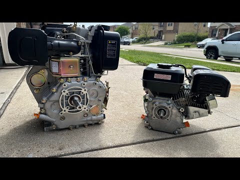

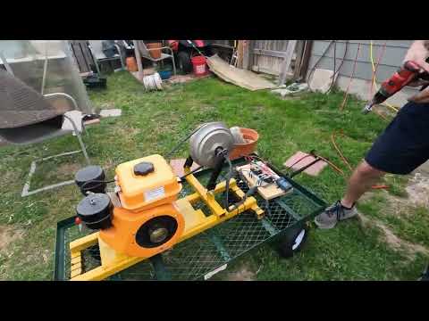

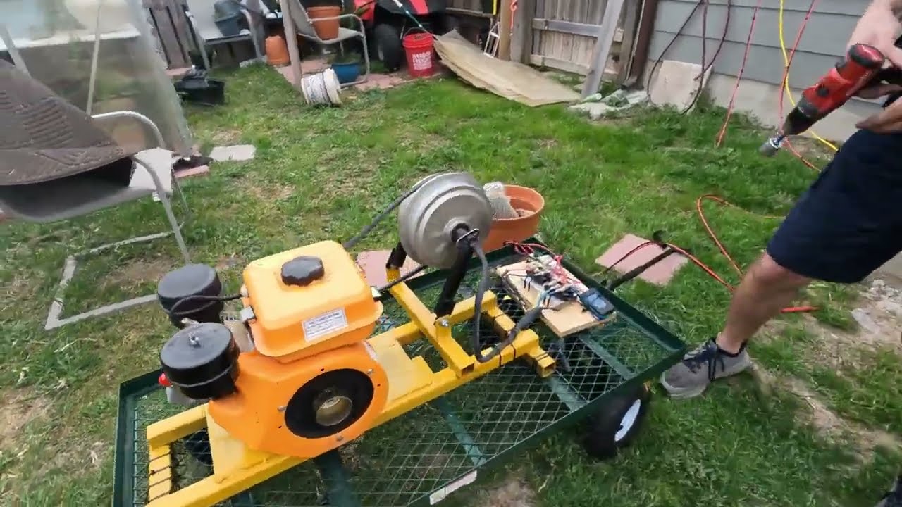

I started collecting these suitcase sized inverter generators some years ago , seems so many on the market for offers due to non working , most common fault on the ones i collected was the ignition module gone bad , at least 3 , 1 had a valve that decided to play chicken with a piston and 2 that had inverter faults , all seem to use the same model engine and some parts are transferable to other models , these days i only bother with the electric start models if i am going to gasifier its use .
Still struggling with diesel engine , but wont give up on the pile of crap just yet .

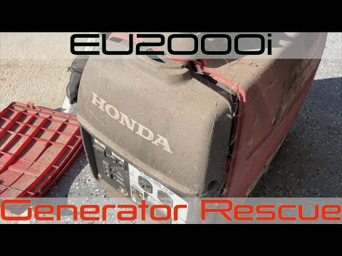

Honda 2000’s inverter-genrators, excellent performers as they are; are not fun to work on for most of will be needed maintaneces and repairs.
Watch this video for what it takes to gain access, to adjust the valves.
How far needed to disassemble when needing to replace the recoil starter pull rope:
Look back at my picture set above. I would not even have had to split the clamshell cover case halves to pop the engine top cover to adjust the valves. Just pop off the side access cover and remove four nuts.
From where I was with the case halves lifted off; it would be just four more nuts to remove, and take off the starter recoil cover for pull rope replacement.

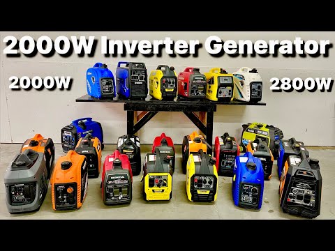

Yes Dave some guys do collect these:
Ha! Ha! Except his were all got new for reviewing. Now being sold off.
At least six have the exact same external case shape as mine. Just different colored plastic clamshells. Different front face controls layouts.
“Gavin” also has collected tons of 3000-3500 watt units. 4000-5000 watt unit with electric starting. And 6000-9000 watt units.
Sorry man.
I’m no help on your single cylinder Chinese clone diesel engine.

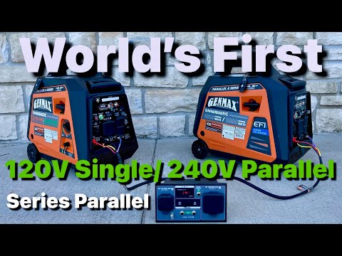

The Genmax series parallel looks interesting. I use a 120 to 240 volt transformer and soft start controller to run a 2 wire 220 volt well pump on my 120 volt inverter generator. When my old 3 wire 220 volt pump died I replaced it with a 2 wire.

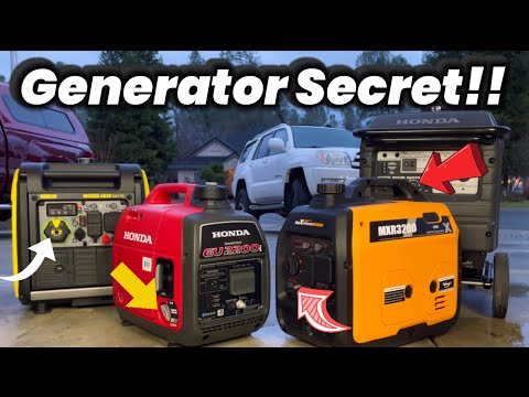

Hi Guys I am still searching for a video where the guy is claiming that just by turning most of the small iIC inverter-generator clone units rotate valve to just before ignition grounding cut-off; the fuel will be cut, allowing engine running-dry at the carburetor and lines. Find it: I’ll edit insert it here.
I did find a good video in detail comparing the newest designs; thoughts and products from Honda versus the Yamaha.
Face it. Thses two BIG companies the ones doing most of the original engineering to standards. View on for the fuel use performance specs under three different loadings usages. Showing the differences in these two systems running RPM and noises
Intersting to me on the earlier Honda 2000’s was the super low mounted rotary fuel/on-off knob. The 1st generation Yamaha had a much easier to reach high located control knob.
Better closer located operating controls. Was slightly small than the Honda.
So why did Yamaha change now also to a low located fuel control knob too?
I think I know. Fuel leakage fire safety:
My high front mounted fuel valve and lines; when-if ever leaks and it is down onto electrical energized and heat-hot things.
Big OEM manufacturers have to think ahead for big dollar liabilities.
A distributor-named brand can just fold up; go-bankrupt, and move-on, reorganize. Just like the lowest tier used car lots do a lot here.
Ha! Ha! I still say buy 2-3 clone units.
I personally want to be aware of the OEM’s as desirable used found units.
Thanks Steve for the videos !!
So simple but I never thought of it ![]()
Hey Mr. Steve .
I just tried the shut off trick on my Honda eu2000 and it doesn’t seem to work on it ![]()
I think this will be a hit or miss possibility WayneK.
I’ve been putting a half quart of Aspen4 fuel in my now four inverter-generators and the Bilt Hard 2500 and the Yamaha 2800 do the almost turned off knob trick.
Our Honda 2000 and Harbor Freight 9500 do not.
These last two have pulsator fuel pumps. Maybe that is why. With pulsator fuel pumps for-sure they can feed themselves from extended run boat tanks of gasoline.
The gravity feed machines? I do not know. Maybe if the auxilery tank is mounted up high?
Now videos out on GENMAX having a new electric pump screwing into the stock fuel tank fill neck for positive auxiliary tank pumping

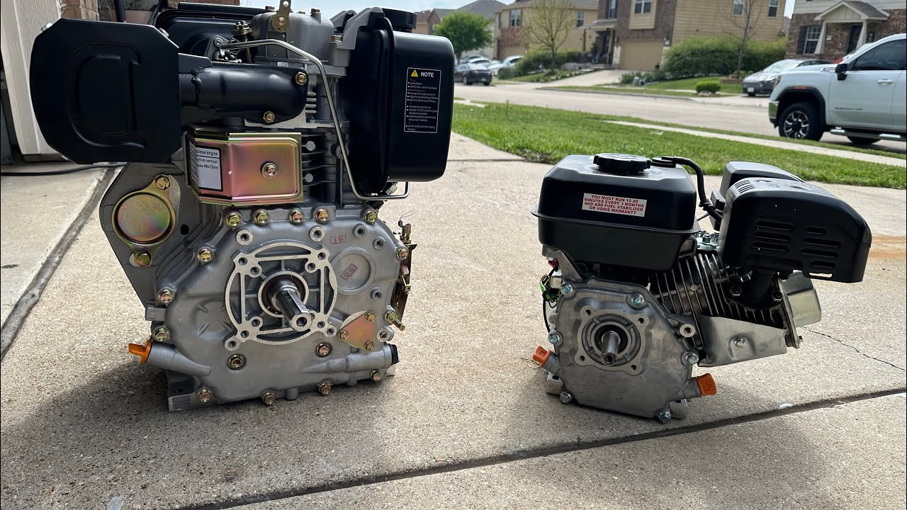

Hey @d100f Dave is your Chinese inverter diesel engine the large vertical air cooled?
Or the smaller slant cylinder air cooled?
Or even a water cooled one?
