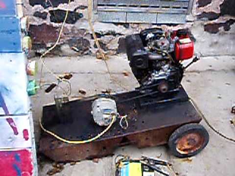

YouTube says this was 14 yrs ago. The Yanmar is still going strong, still charging batteries, with free fuel, and free alternatorsā¦
Even the clones are great. Iāve though about tapping in an oil filter for my 10hp clone. Do you think that would be worth it? Or is it a non-issue?
Just change the oil every 100 hours. Oil is cheap! That lil 2.4kw Yanmar doesnāt take even a quart. I have never noticed the cost of the oil for this engine.

Thatās fantastic Bruce , What type of free oil are you using ? i did think that if my source of veggie oil dryās up i could just use the old sump oil we get in once filtered , like the black diesel guys use on YouTube .
Yes Tom i have also looked at getting a double pulley and mounting another alternator on the other side , but i think i will leave it as it is now and just see how it works out for me in the coming weeks , Autumn days are here and the clocks go forward in a week or so , time to get playing .
The Yanmar has burned: vegetable oil, sump oil, hydraulic oil, fuel oil, gasoline/veg oil, turpentine/mineral spirits, transmission fluid, and light mystery oil (perhaps it was lamp grade kerosene, or jetA).
Oh, and several hundred gallons of Biodiesel. (1 quart at a time, LOL!!!)
