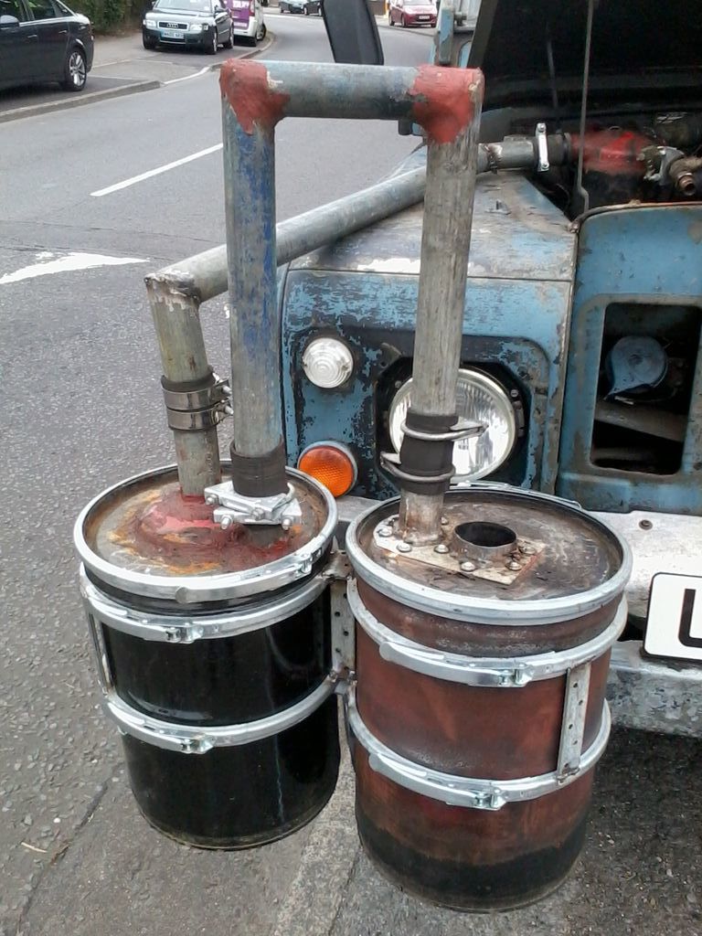

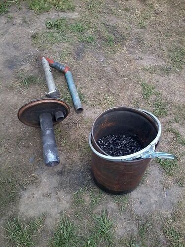

I did, funnily enough, get a bottle of de-ionized water from the car spares shop, or more accurately, I paid for it and left it on the counter- it’s sold for steam irons and battery top-ups, but I have raced ahead a bit, and I’ve actually had the Landy moving on producer gas. An entire ten yards backwards and ten yards forwards!!! Hey, it’s a start. Attached is a photo of the core gasifier, and the setup on the front bumper- it is of course, too smal to drive on- I’m only thinking in terms of driving the vehicle alternator at the moment.l One thing that struck me is that there’s 2-3 metres of pipework between the combustion zone and the manifold, so there will be a bit of a lag between doing anything to the gasifier, and the effect, as measured by the lambda sensor. There is, however, an LPG stepper valve right there in place- I’m wondering, could it be used to tweak the air mixture?

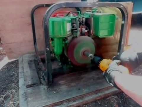

I got in a couple of hours running on the Landy- Gilmore-inspired gasifier with a 3" diameter tuyere, followed by a cyclone and the existing oil bath air cleaner. No startup fan- I start on propane and wean it onto woodgas. What’s good about the setup is everything’s right there in place- electric start, lambda probe, stepper valve and propane, the niggling doubt is whether I’m on the road to nowhere with a large engine under light load, and a small gasifier. I want to get a backup engine going, but the lack of success with pull starts is a bit off-putting. I want something like this:
but with some sort of safety disengagement mechanism.
Like many others, I have used this process from time to time, but only during diagnosis of engine problems since, at least on the 2 videos above, the flywheel shroud is off of the engine once it’s running. Do we think user is good at positioning the shroud while the engine is running? Do they then bolt in back in place?
There are engines where one can remove the recoil mechanism while leaving the shroud in place so it can provide proper engine cooling and proper air governor function. And for those engines, I see this as a real solution. If I had to do it to an engine where the shroud has to come off, and if I thought I might fix the recoil starter some day, I’d go to a small engine shop and get an extra shroud. Then I’d cut off the recoil supports for access to the shaft nut.
