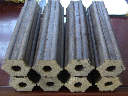

Quick word, I just use scaff pipe for the plumbing- it’s about 40mm ID, which is just too small for the distance that I’m piping it- shame, because it’s everywhere. For the tuyere itself, I use a bit of 75mm thick wall gaspipe, big enough to feed a piece of 2" x 2" down- I’ll try the refractory in the fullness of time, but it’s just not the priority at the moment… but have a look at this:
…can anyone see wooden tuyeres?

Hi Brian , Yes they certainly would make very good 5 minute lasting Tuyeres or if you could have them self feeding down your pipe as a sort of self replenishing nozzle , might work , give it a play on the weekend and see .
