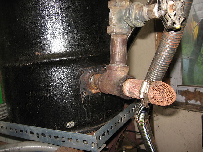

This post was also put under the heading of “what not to do” but in case some of you do not look at it, I have put it here too. This is something that happened to me too but did not think much of it. However, with Brian getting injured, I feel now is the time to state that the Simple Fire design has this inherent danger that operators must be aware of. DON’T LOOK DIRECTLY INTO THE AIR INLET OF A SIMPLE FIRE. There is a danger of blow back of charcoal embers!!!
Hi Brian, Your experience with a belching gasifier is something I also experienced. Fortunately for me, I was not looking in the air inlet when it happened. But I saw the event happen and it shot a shower of sparks ten feet out of the air inlet. After seeing that, I built a screen over a pipe nipple that screw into the air inlet. At the least, it will slow down the velocity of any charcoal embers that may get expelled from the generator.
Here is what I think happened. It was at the end of the run. There was a small air leak in the lid of the charcoal gas generator that allowed a little oxygen to mix with the charcoal gas before leaving the generator. As the charcoal is consumed and drawn down, it allows the heat generated at the oxidation zone to move upward into the generator. At some point, there is insufficient charcoal to insulate this combustible gas from the heat and ignition occurs. The sudden increase in pressure pushes hot charcoal embers out the air inlet. This is not the time to be looking at the glowing coals!!!

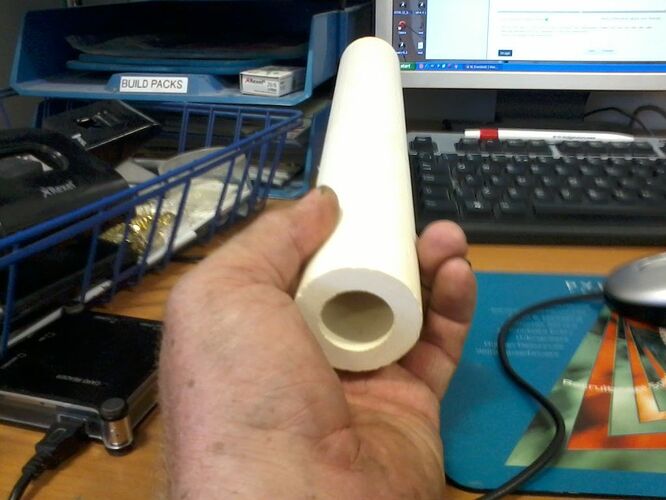

Pete… Have a look:
http://www.tcdirect.co.uk/Default.aspx?level=2&department_id=190/1
It was a Nicrobell D sheath rated at 1250 Celsius, and it’s fried. At a cost of about 30 pounds, I’m wary about pursuing this line- here’s what I’m more inclined to pursue:
The answers that I want sooner or later are: optimum temperature for gasifying charcoal on it’s own, and optimum temperature for cracking hydrocarbons.
