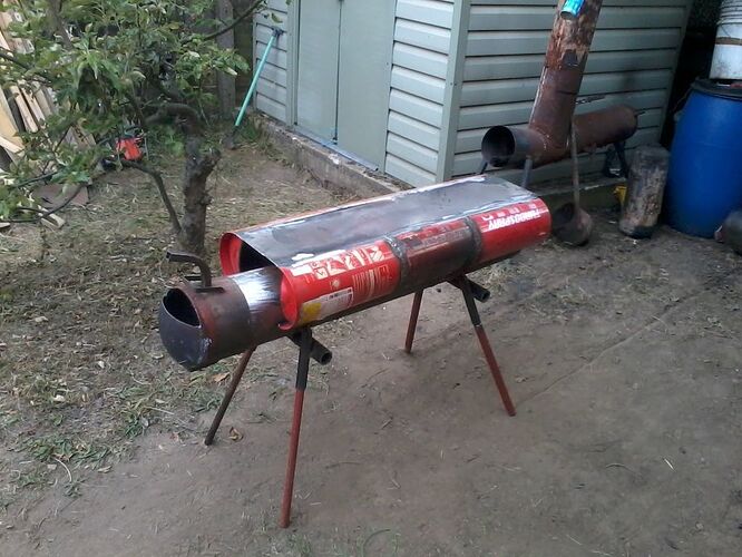

I managed to make a bit of progress with the Mk3 SOR stove- photo of work to date attached. It’s got an enlarged secondary combustion chamber, folded back on the feed tunnel to pre-heat fuel and air, and a flat top for cooking… but dontya just hate it when the MIG wire runs out at 5pm on a Sunday. To be continued…

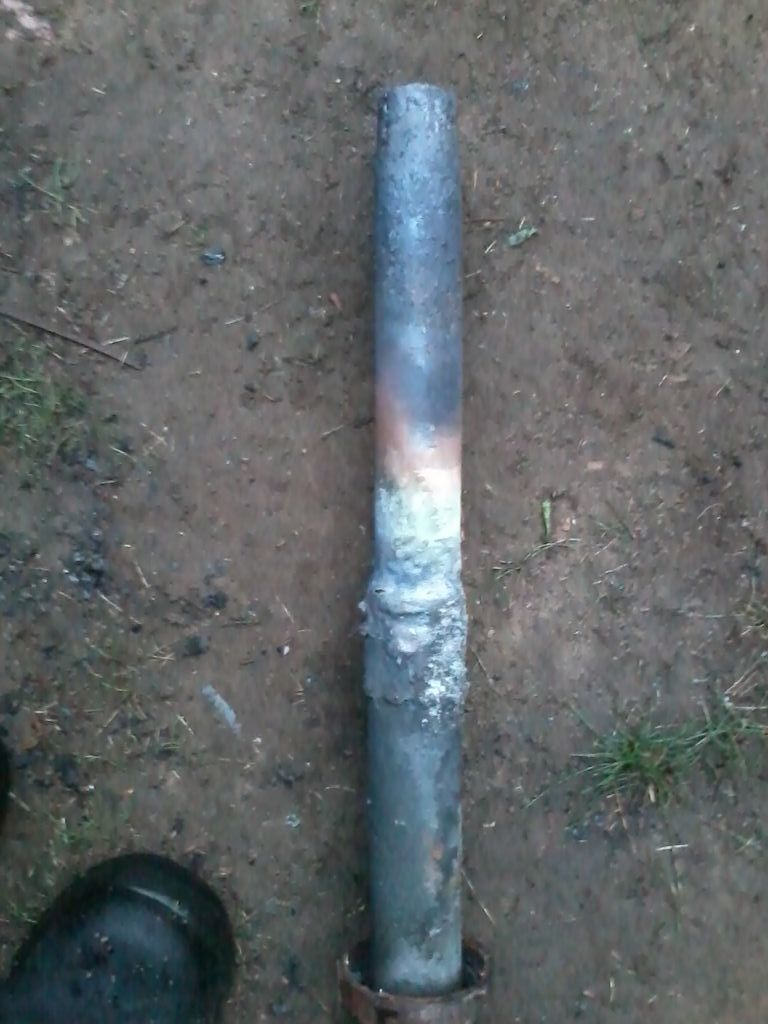

To Brian Hughes: Thanks for the feedback about the probe. Did you ever get any actual readings before the T/C failed? How high were they? I noticed that the "Nicrobell D sheath was only available for type N T/C’s. Was your T/C amplifier (readout device) reading that scale?

Pete… I was just using a multimeter and some mental arithmetic- the type N reads 39 microvolts per degree Celsius, or about 25 degrees per millivolt, near enough. Unfortunately, things unfolded too quickly to recall readings with any certainty, but “In excess of 1000C” would be a good bet- certainly hot enough to melt mild steel.
Quick update… slow progress at the moment, since the festivals are coming thick and fast. The Mk3 SOR stove is finished and working well, but it’s now so far removed from Rocket Stove principles, that I call it the Tunnel Stove. I’m just about out of the neighbours bad books, having had a marathon session of welding and angle grinding, lighting up, which of course burned off the coating from the extinguishers, and then ringing the doorbell to apologise, which woke their baby up.

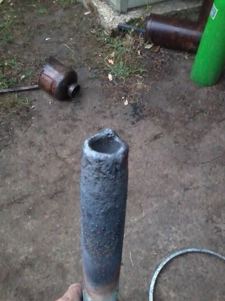

Managed to cobble together a new tuyere nozzle from a kiln shelf support, a bit of scaffolding pipe, and some kiln cement- photos are attached of the results after a half hour charcoal test run with no moderation- looks encouraging.

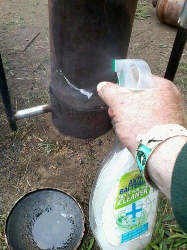

Managed to do a flare run today with the new kiln prop tuyere- the downside is the poor mechanical strength- it breaks very easily, but if you’re careful, it keeps it’s shape better than a straight mild steel scaffolding pipe. One tip… use a spray bottle to find the hot spots on the outside of the gasifier vessel. I was a bit surprised at how defined the line between the hot and cooler areas was.
