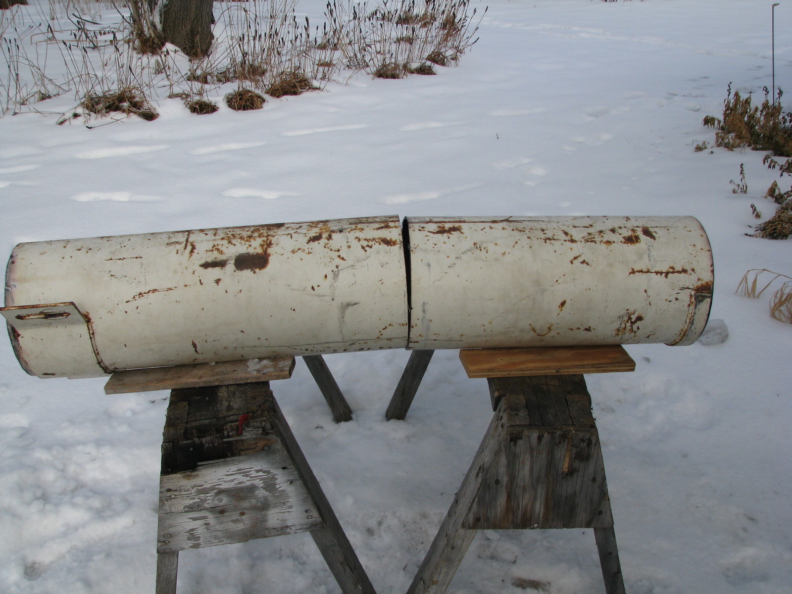

I had a great find in my brother’s scrap pile. It was a 10" od ice chute from a Zamboni. Happy birthday and I have a piece for another project. I’m looking for some info (dimensions) on the air ejector I used for my FEMA. It worked quite well, but had a 1/16" nozzle hole that would gradually get coated and poop out. Remove and clean, fun.

I just took a piece of flat stock that I found at the junk yard and cut out a rectangle the proper size. Then I took that to a shop and they rolled it into a 10 diameter fire tube. This way you can get what ever gage you need and don’t have to settle for something to heavy or light.TomC
